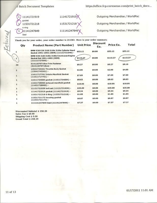

rjcaptsean, i dont know if you have bought new gaskets yet or not. but FCP has pretty good prices, and they will price match getbmwparts.com, 149$ and up gets you free shipping..
The head gasket is goetze, and the other gaskets are victor reinz.
  the gaskets for my head job cost me 114$, that is replacing every gasket that is touched doing the head gasket, including the head gasket and head bolts.
