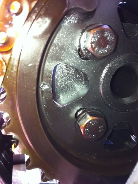

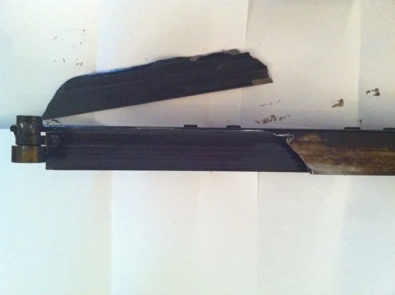

My cam gears looked great as well.....
Even after the chain rail snapped in half destroying the lower guide and jumping 1 or 2 teeth.  Nearly cost me my engine.
If your cam gears are fine there is a good chance the crank and idler gears are too.  If you are trying to do this cheep I'd replace the tensioner first and see what that does.  If you don't want to take any chances I'd replace all 4 guides, chain and tensioner.  Safest option would be to replace everything.  Get the gaskets and your set.  Specialized BMW tools are not a necessity but would make life easier.
Edit:  I was only getting the diesel sound at 2800-2900rpm didn't seem too serious.  However, I also had pieces of plastic in my pan.  After 3 years you may too.
