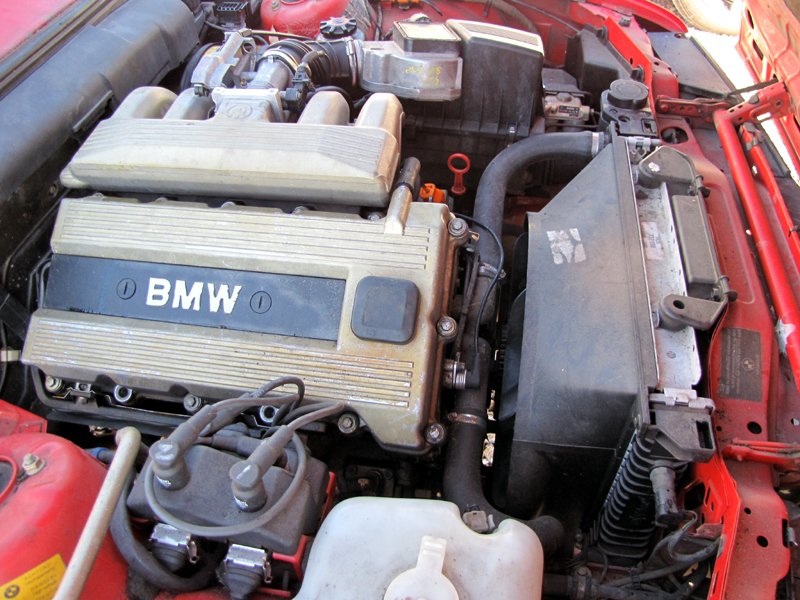

Updates. Did heater plate delete. Messed up my shoulder in the process, but I got it done.
After upper intake came off
SLUDGE
After lower got pulled and cleaned. All sludge removed. Denatured alcohol and carb cleaner
High temp black intake, next week I'll do the valve cover too.
I had a hell of a time plumbing the icv, all the hoses I tried wanted to collapse on the case side. Ended up putting it basically where it was. I need a new intake boot now, as I found a crack in the secondary (unused) vacuum port on it. Anyone know where to get a boot with one port instead of two? I know some had the port near the tb blocked off.
Mostly assembled
And finally, my ac recharge rig. Kits for sale soon!
Digging now for the part number for the lowest temp aux fan temp switch. Anyone know it?

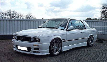

this is the seidL front apron and sides
jscribble
  • Posts: 283
Jscribble - Jason from WI
« Reply #8 on: June 28, 2010, 11:59:08 AM »
Thank you for that. I think I'm going to stick with more "traditional" on those, but I bet the front is exactly what a turbo needs.
