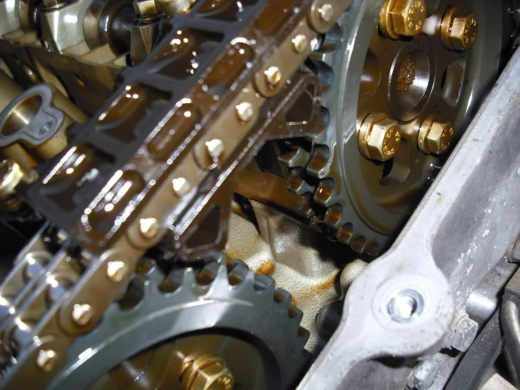

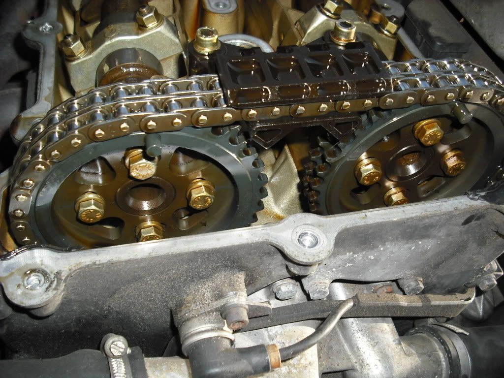

Lastly I pulled the valve cover to take a look at the top of the chain. Other than looking at the teeth, I am not sure there is any way to tell if the chain and/or guides need replacement from looking at it from the top, but here is a couple pictures of the cam gears & chain....
As you can see, the gears are definitely not pointed or apparently worn. In fact, to my un-trained eye, everything looks very good, almost like it has all been replaced at some point. It doesn't look like the gears have 168K on them to me, but I don't have another M42 around to compare with. What do you guys think? The upper guide looks great as well, the chain feels tight, & there was no debris in the pan. However, I obviously can't see the lower guides from up top, is it possible they are still hammered? Thanks in advance everyone!

There is a VERY simple way to know.
Open the oil cap, and shine a light in and look at the sprockets,yes you can see them. You only need to see one. If the teeth are sharp, its done. The teeth should look like the picture above with slightly flat tops. Not spikes.
The tensioner matters, but if the teeth are worn it means your chain is stretched, changing your tensioner will do little. If the teeth are worn, the guides will be as well. The teeth wear because the chain no longer fits between the teeth properly due to stretch, this puts pressure on the front and back side of the teeth. If the tops of the gears are curled over at all, change it NOW.
