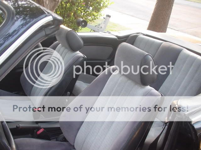

Will do.  Mine are the cloth two tone sport seats that look like they've been reupholstered once already as they are in great shape, but the seat mechanicals need to be renewed.  They all need a good cleaning...  Drivers seat does not recline and it's missing the seat height adjuster lever.
Minor fixes.  I'll add in new struts on the drivers side after I finish up the engine compartment renewal I'm working now...   :cool:

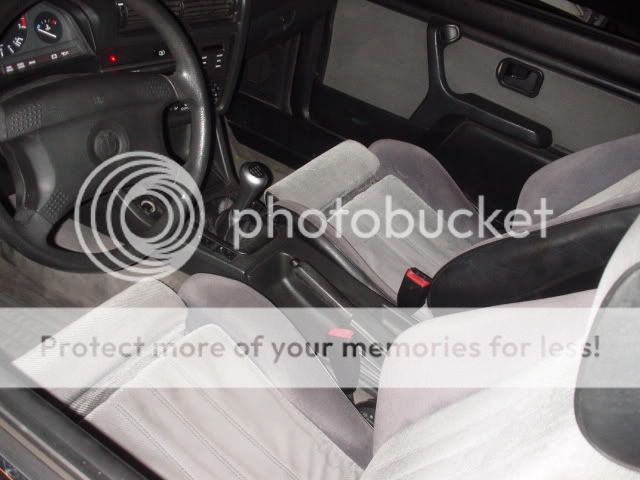

What a great DIY, thanks for putting that together!  I did pull the drivers side last week and had it apart.  it was fairly gummed up and could use some new pistons, but after getting it apart, giving the hinge and release mechanisms a good cleaning and lube, and getting it back together, it operates just fine now.
I also hot shampooed the seats about six times and pulled years of imbedded dirt out.  Probably a few more years of imbedded dirt in there, but they look way better.
Thanks for the link and info!   :cool:
