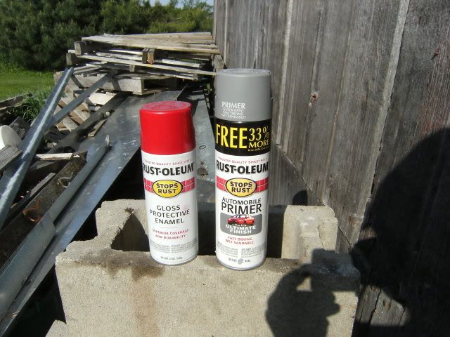

I used sunrise red that was suggested on another thread on this site and it was a near perfect match.

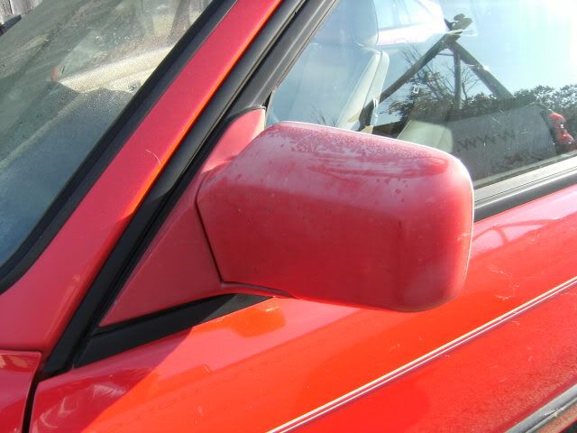

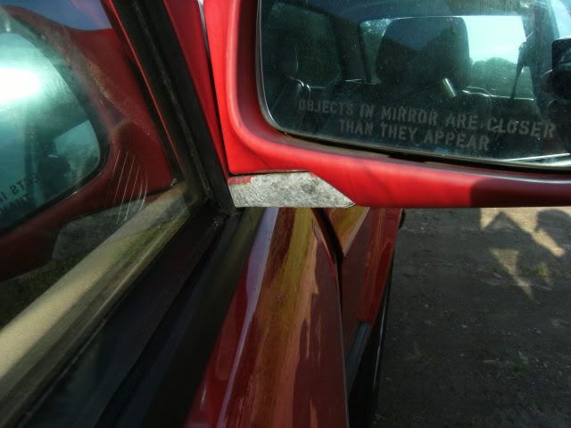

Crummy looking mirrors.

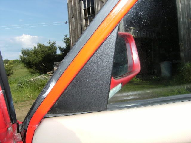

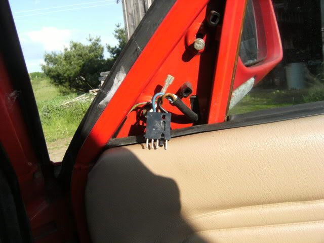

Pop off  inside cover and remove two bolts that hold on mirror. Wiring just pulls apart.

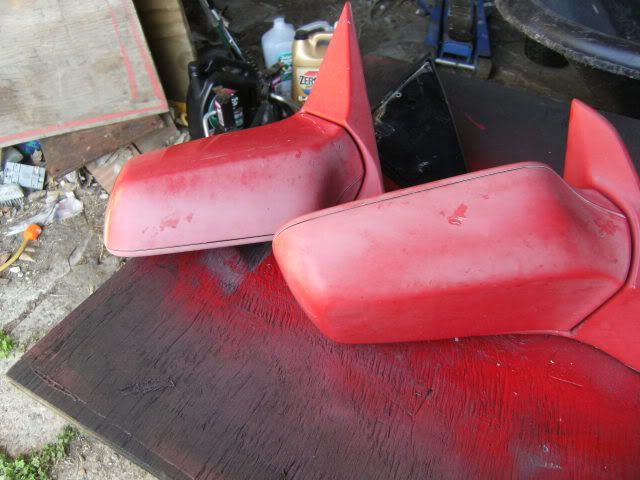

UGLY......

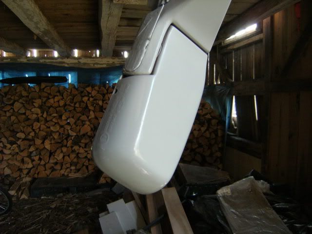

Ready for prime

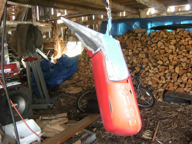

Primed

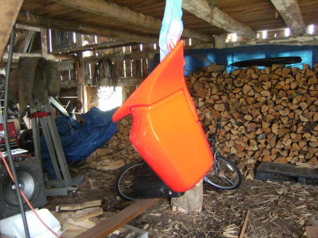

Paint(flash changed the color)

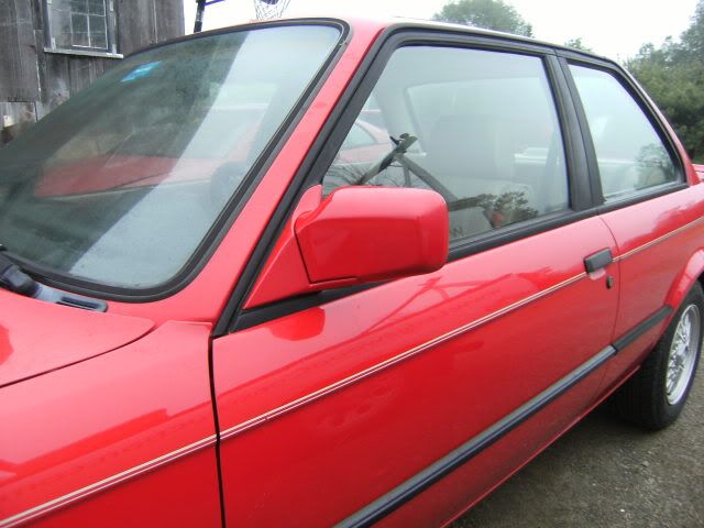

Re install and enjoy......
