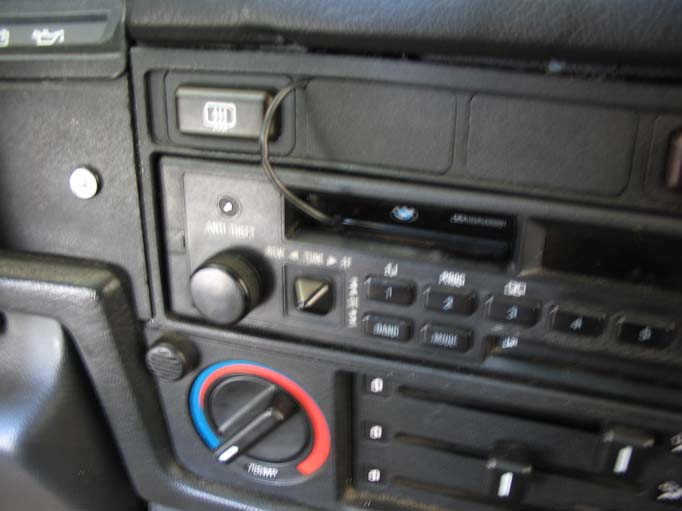

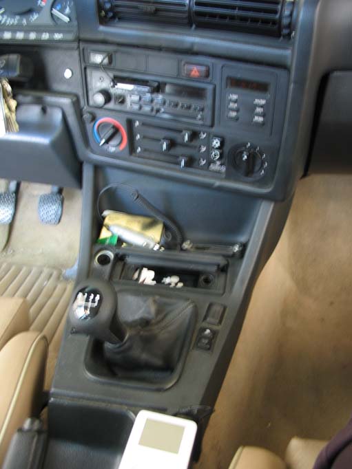

First, you will need to pull the head unit. You do not need to disconnect anything.
Then remove the block-off plate above the head unit.

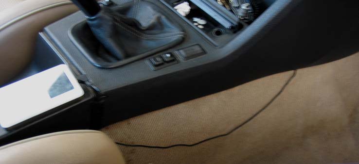

Run the Ipod connector in through the block off plate. Stick yourhand in through the head unit hole and guide it down the side, as far back as you can. With your other hand, pull up the lower edge of the center console, under the dash.
You can see in the pictures below where you want to exit. It may help to push a coat hangar through from the bottom up first, tape the connector to it, and pull it back through.

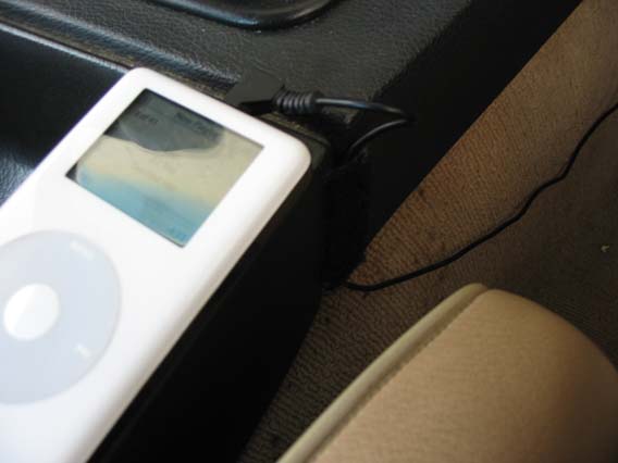

Run the cable along side the center console, and up through teh gap between the consoles (see pictures). I used a peice of velcro to hold the wire in the slot. You could also drill a hole behind the ipod. I chose the non-destructive route as I planned on upgrading to a Ipod ready head unit (which I did today, my Ipod is now mounted in my glove box with velcro).
I use a peice of black industrial velcro to hold the Ipod in place. It is not very noticeable when the Ipod is not in place. I used a white peice on the Ipod. The placement is handy, it has worked well for me for months. Once in a while the sun catches it and reflects in my face, but this is extremely rare and could happen almost anywhere you mount it.
Tuck the cable up inder the console and push any extra wire up into the main console under the stereo. Put the block off plate back in place but leave one corner pulled so the wire can pass through. Put the cassette into the deck and make sure there is a little slack before you button it up fully. The idea is as little wire as possible showing. You could also drill or grind a small slot for it.
Re-install the stereo.
Pics....
