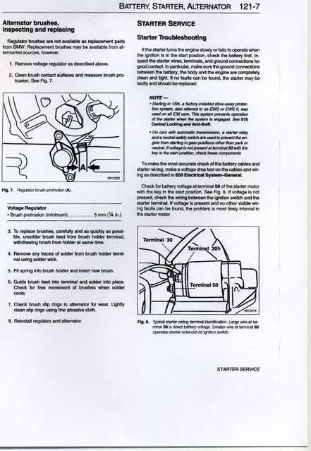

I'm pretty sure I have the solenoid wired wrong. The starter motor is getting power  and spinning but its not kicking out to engage the flywheel.
I'll try to describe how I have it wired.
Looking at the solenoid from the front of the engine I have three posts. I have the red power cable and the cable from the alternator going to the same post on the far right. I have a smaller cable going to a small post at the top left of the starter solenoid. I have nothing on the post down and to the left of the right most post (where I have the power connected).

maybe this will help............

Thanks for the diagram. I ended up figuring it out.
To anyone that has the same problem in the future you need to have the skinniest wire on the post at 11 oclock, you need to have the wire coming from the battery and the wiring coming off the alternator on the largest post and the second smallest wire on the post at about 5 oclock.
