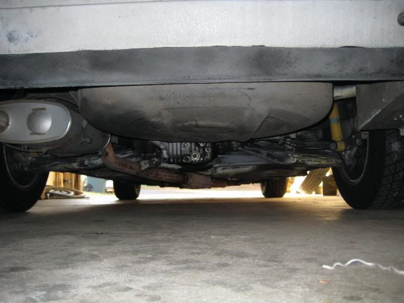

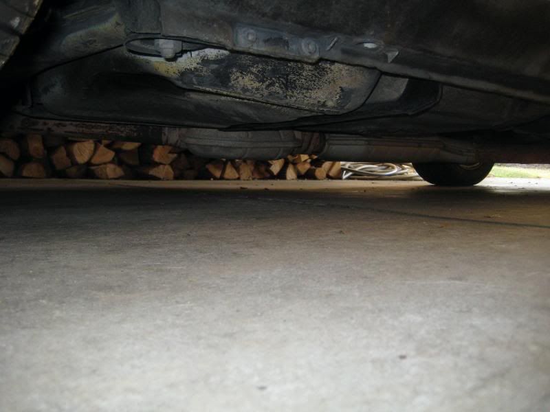

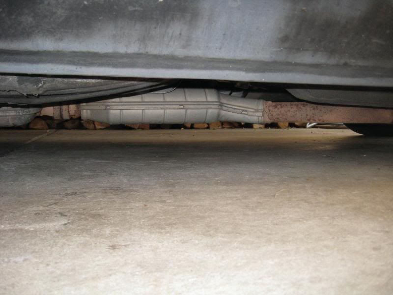

Its been like this ever since I bought the car 7yrs ago.  Looks like its just hanging low in the middle.  Could it just be old?

Is your tranny exhaust support connected?

not sure what this looks like.  But probably not.  I was shaking the exhaust from the tailpipe and the whole system was shaking up the the downpipes.  Anyone have pics of the support?

Basically, you need parts #4-14.  I'm sure a salvage bracket would only be a few bucks.
You should also replace the pipe and muffler hangers (3 in all), #7, #12 (2).
