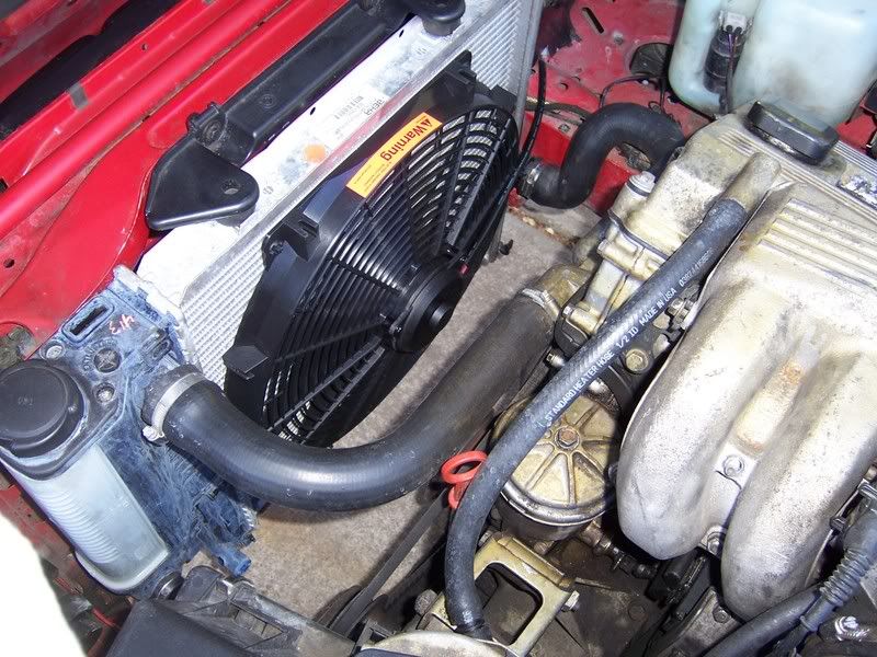

So after i posted up what was going on with my car i went back to it and bleed the system over again. In all i bleed it about 5 times. I took off the clutch fan and i removed all the a/c including aux fan condenser ect. I drove the car with no fans and it would not overheat so i think it was just air bubbles in the system .

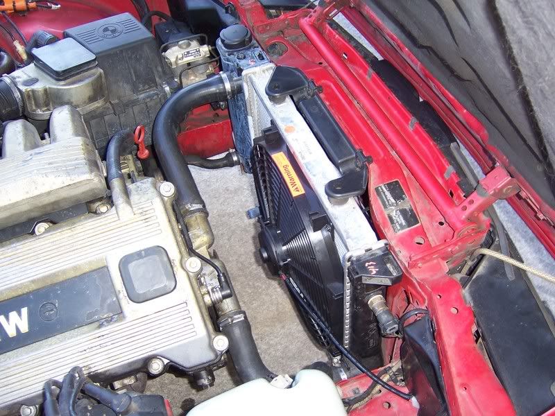

But i allready ordered the electric fan so i just installed it for more cooling then the clutch fan. it is a 16" flex-a-lite fan with 2500 cfm. I hooked it up to the aux wires with a over ride so i can turn it on if i want to.

When you wired your electric fan, you ran it through the Aux. fan wiring, did you keep the Aux. fan in front. Or did you use the wiring and mount a switch on the dash. You see.. I want to do the same thing. 1st remove fan clutch, 2nd wiring up electric fan. Did you use the ceramic heat sink that the original aux. fan has, or what. I would like to know how you did it. Could you e-mail me some direction. at

I did not use the heat sink. All i did was cut the wires going in to the stock aux and splice them in to the electric fan. The brown is the ground and the black is power the red not being used. And i put a 20a inline fuse form fan to aux wires. If i did it wrong could someone let me know. Plus i am not sure were the thermostat switch is.

Thats the location of the thermostat switch for the fan

thanks i thought so but when i read others saying they run the fan from that it does no make sense to me. So what i did is ok then just cut the aux fan wires and splice them into the new fans wire? i looked all over and could not find pics to which wires to splice oh well it works just dont want to mess anything up.
