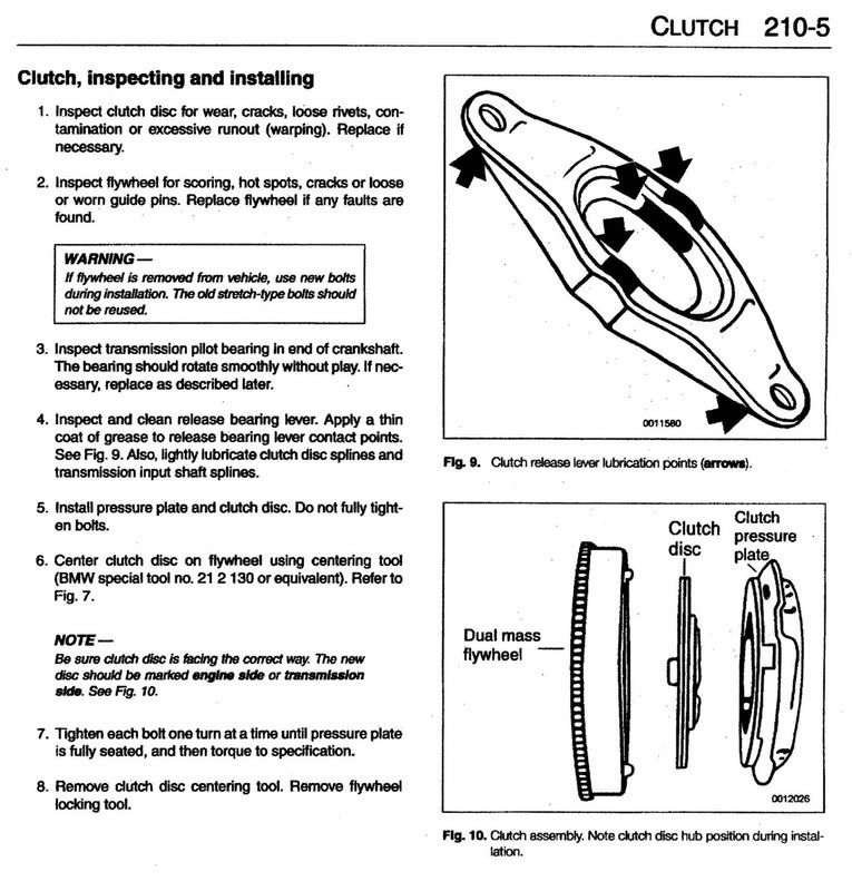

There is nothing in the E36 bentley manual about thickness.
