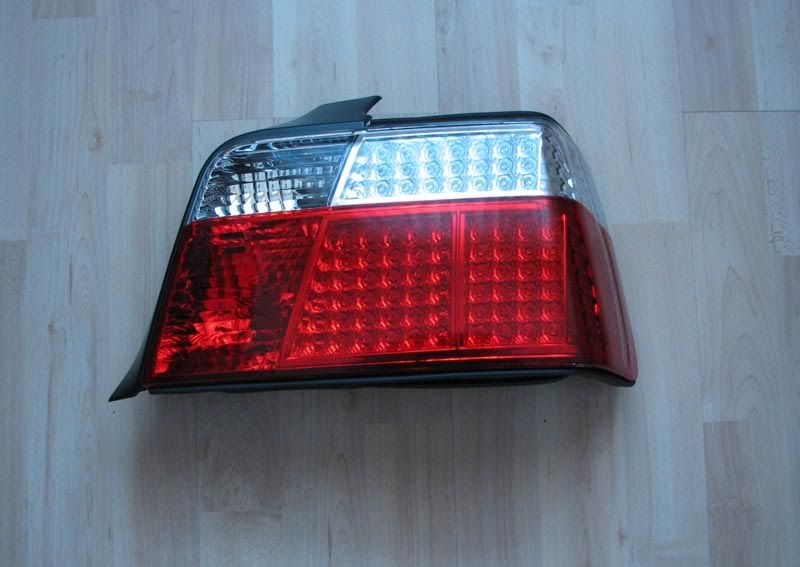

I hate myself already, but today I bought one of these:
Don't ask me how much they cost (194$), but it's a lot (to me anyways)…
I guess I'm beginning to suffer from something called riceomania :D
Here's what was inside the box:

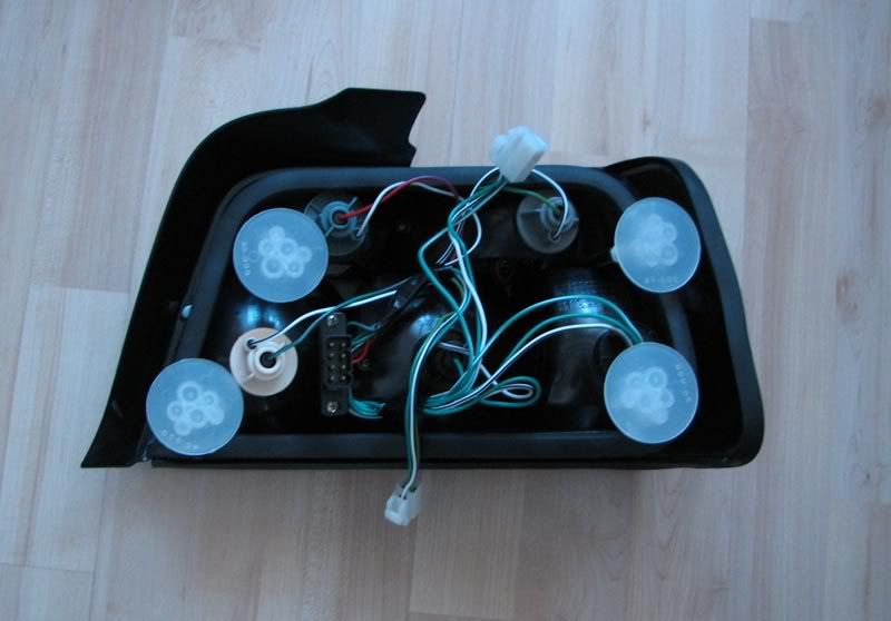

Pair of these:

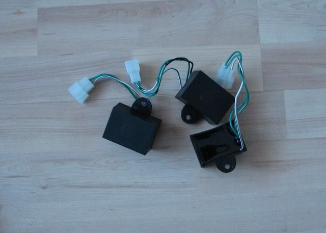

4 voltage regulators i guess (couldn't take them apart to see what circuit is inside):

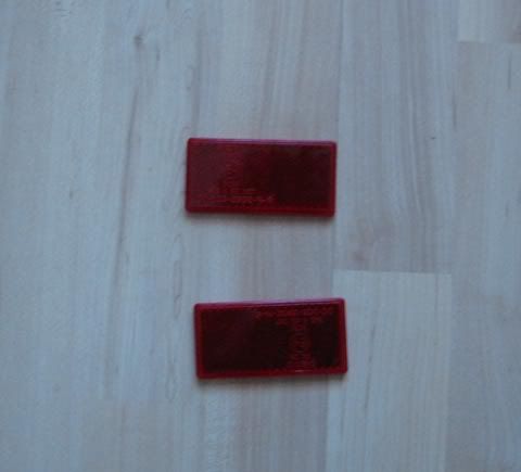

2 reflectors (when I saw these I realized that the lights themselves don't have a  reflector):
Installation manual:
Now I'm in the process of rewiring the lights, so that they light up in the right places
I also scraped my plan to build custom voltage regulators (because they were already included)
What do you think people, is it safe to drive without any reflectors in the back? Coz I don't want to glue them to my bumper

I'm assuming you have an E36. Anywho, the 'voltage regulators' that you speak of are really only just big resistors to slow down the blinking of the turn signals and to prevent any OBC light errors. This is because LED's have less resistance than incadesent bulbs.

How do you know that they are resistors?
I checked those "regulators" and it measures resistance in every direction
Guess that means that there is no voltage regulator transistor inside, hmm I'll have to sort out that wiring tomorrow, so maybe I'll understand how it works :)

The first generations had resistors for the blinkers just like the angel eyes but the later ones got the voltage regulation circuit primarily to make the LED's last longer. I overlooked the fact that you just bought these so most likely, you got the voltage regulator version. Let me see if I can dig up an older LED light that I took apart to study the regulation circuit.

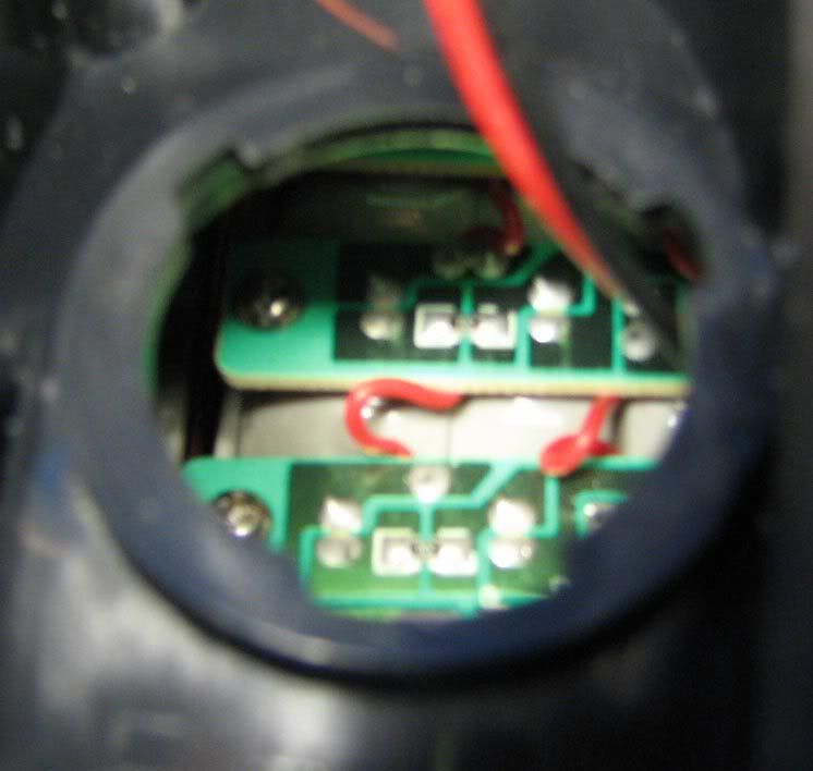

As far as I can see there are only resistors inside the light itself, I don't know whats inside those black bricks I called voltage regulators though, the insides are completely sealed with some plastic
