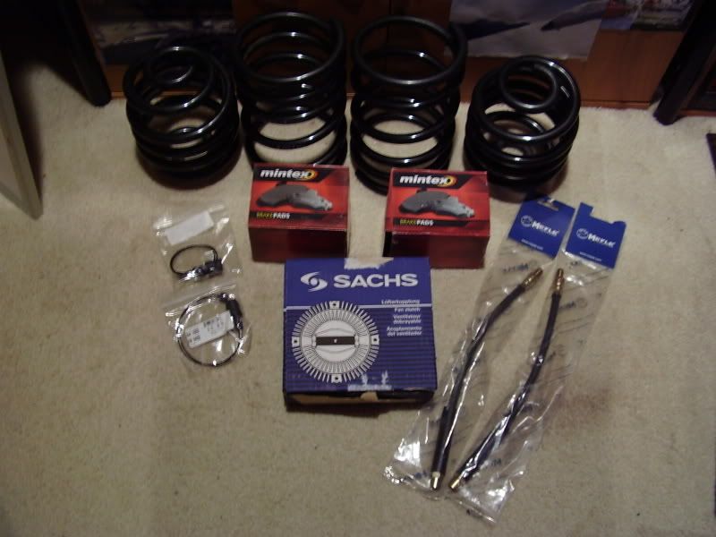

Yep, got all these parts and are all ready to go in next wee(spring break) and then I'll b able to handle and b having some fun.
Sitting there is IE Stage 3, shocks are not in pic but are Rancho RS9000 complements of e9nine I got them all figured out, then Mintex red box, new lines for front(back I am getting tomorrow at parts shop), new brake wear sensor.
I'll post up pics next week once I'm done w/ it. Crappy pic sorry.

Turns out the rancho's don't fit at all. They are about 7 inches too short out back because I got the spring compressed on the back as low as possible and it could almost fit on w/ the shock fully extended. The front is too fat and won't even fit into the strut. Luckily the people before me put on some gas shocks which I did comparisons between those and the rancho's and they were pretty equal so I used those instead.
Brendan
If you are doing auto-x, these pads will be perfect.
If you plan on tracking your car on anything bigger than Bremerton Raceway, get some better performance pads.  You'll melt these in a track day.  BTDT at PIR in my 944S2 with Mintex standard pads.
Mintex makes a C-Tech brand or I reccomend a Hawk HPS (that stands for "high performance street").  You can still run them on a daily basis but will hold up to the punishment of track driving.
