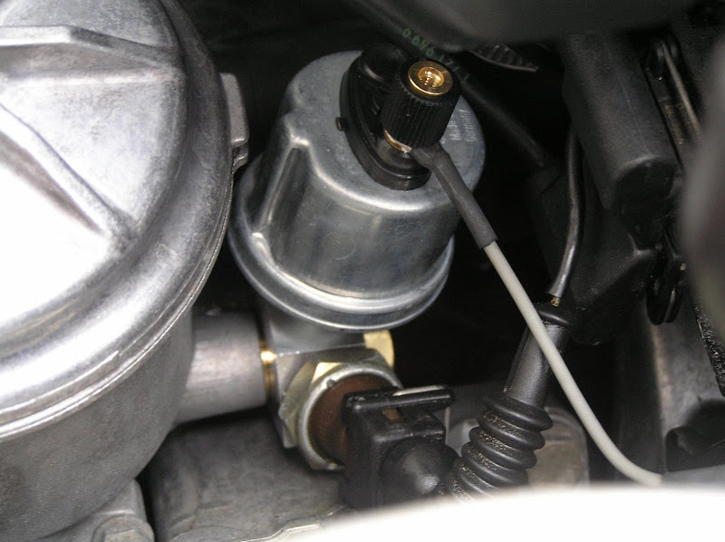

The OE sensor is located at the base of the oil filter, pointing parallel to the engine block.
I used an adapter and have both the OE sensor and my gauge sensor in that port. Unfortunately, the place I got it from looks like it is no longer around...  the website is dead: http://www.gaugeman.com
