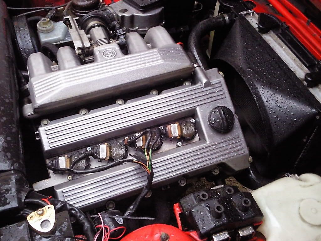

« Reply #7 on: February 09, 2009, 03:08:10 PM »
UPDATE: I just did my COP today, made my own plate out of Stainless steel sheet, I secured the coils with self-tapping screws and it feels really solid. I only need to run the wires a bit better and shorten them but the car runs perfect, It cost me €50 for 6 Bremi coils 11 860, and a couple bucks for the studs and such.
