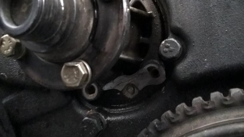

I am currently going through this exact procedure. Took everything apart and snapped off the ears for the screw removal method. I've been beating on it all day and it hasn't moved a mm. Sprayed a mix of brake fluid and atf on there to see if it can penetrate and soften the deposits up, I'll hit it again in the morning "literally.
Pics of my current situation
I have pulled my radiator and deleted my a/c long ago so I have all the room in the world. I am considering hooking a slide hammer with a claw to the shaft and giving it hell, but I think I'll try your guys methods first since I have to wait a day or 2 for my friend to bring the slide hammer over.

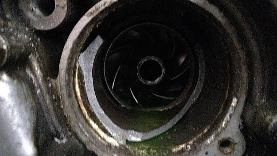

FUCK YOU WATER PUMP! ON THIS DAY, MAN WINS. With the help of his lady.
What I ended up doing is literally stepping into the engine bay, popping the crow bar behind the shaft, putting a foot against the radiator support bracket and leaning back on it like no tomorrow WHILE having my girlfriend hit it with a hammer, her girly taps made all the difference lmao. Meanwhile...
if you look at the bottom of the piece that got stuck in there, I can't tell if that's a warp from heat? I gotta figure out how to pull this turd out so I can finishc leaning it up and button her back up. the impeller in the back is like a super thin aluminum metal, its not as beefy as the one on the new pump i got.

Glad you got it out!  Mine stayed together but it was simply incredible how much effort it was to remove the damn thing.
Maybe you get a slide hammer arrangement to pull the remainders?
