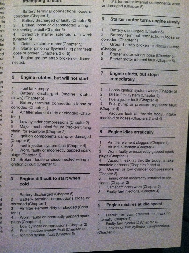

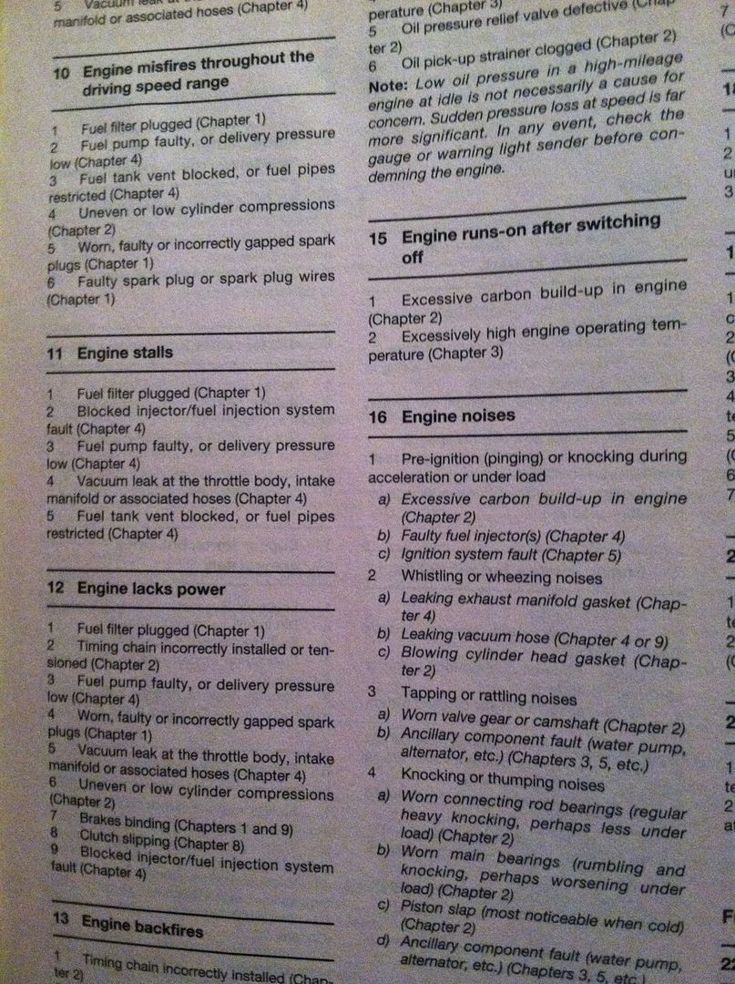

I'd love to take your advice Tgood, but since then my car has completely stopped running. bogged to a stop and hasn't started since. Hopefully someone is still following this, I'm getting tired of these problems...

yes unfortunately these cars are very old now and have lots and lots of problems unless they were meticulously maintained. (Which by the very nature of the 318 being the cheapest model you can buy stateside is not likely :( )
I would recommend you to check out this link which has a link for the full download to the bentley manual; The bentley has tables with the most common symptoms and how to remedy them.
http://www.m42club.com/forum/index.php?topic=2282.0
 here is a couple snapshots from haynes which is another good manual but its not on this site.
