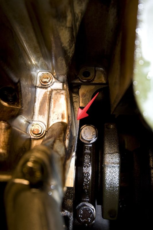

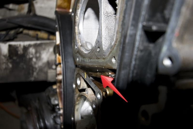

Profile gasket is pooching out and upper pan gasket appears to be as well.
What do you guys think?  Replace or leave well enough alone?

I'd do the profile gasket, but IMHO the oil pan looks OK.  I'd put a little locking sealant on the oil pan bolts just to be sure, but otherwise I'd be happy with it.
You might also have a little electrolysis damage under that profile gasket on the head or inner case - check it carefully.   I've seen a few other M42'ers use JB Weld to rebuild those mating surfaces before reassembly.

Thanks Dave.  I've read some have had success without pulling the head and using the BMW special tool, or drywall knife, or plastic report cover.  Is that  an acceptable method or is pulling the head the best way to go?

@Mabeer: I've seen a few try any flat sheet of metal with a silicone lube to get it in place.  Lining up the oil pump onto the crank snout when re-installing the lower inner housing is the problem...if the oil pump rotor 'ears' are misaligned and the cover gets torqued down it'll crack the rotor.  I haven't done it myself, but that way still seems a lot easier than pulling the head and potentially damaging some valves.
