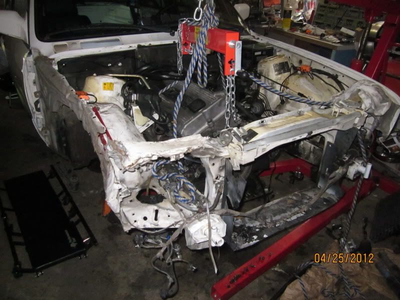

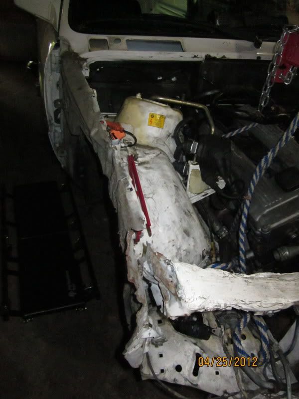

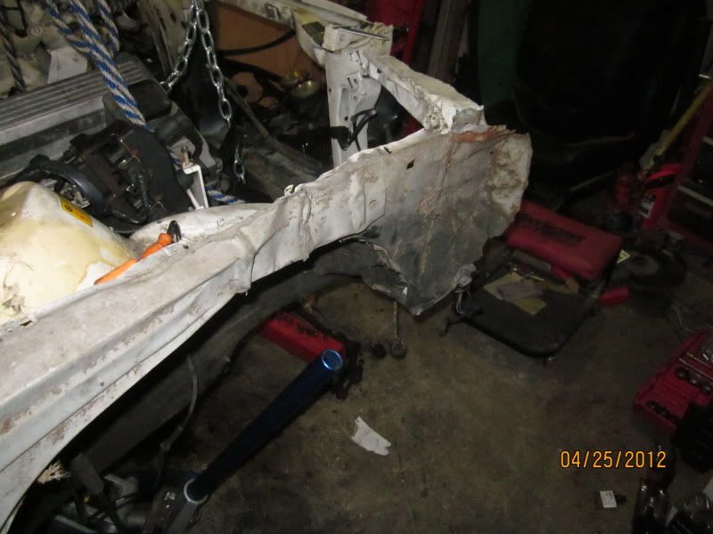

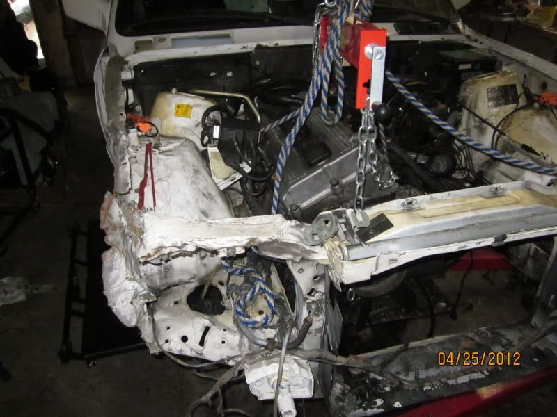

Thanks for the input. Based on my conversations with the shop, they're still fairly confident in their ability to put it on the rack and straighten the frame, but they won't know until it's in their shop (they're one of the top BMW repair shops in the Seattle area). The strut tower and frame rail appear OK (no major bends or creases), just out of alignment.  The strut tower is approximately 1.75-inches inward from letting me install my Sparco strut bar, which seems like a lot to me.
Below are links to a few photos (still can't upload to the board) showing the carnage after removal of the fender skin:eek:
I do know that I'll be needing a new core support:(
http://i3.photobucket.com/albums/y53/mcibmw533/1991%20318is%20project/IMG_7884.jpg
http://i3.photobucket.com/albums/y53/mcibmw533/1991%20318is%20project/IMG_7877.jpg
http://i3.photobucket.com/albums/y53/mcibmw533/1991%20318is%20project/IMG_7874.jpg
http://i3.photobucket.com/albums/y53/mcibmw533/1991%20318is%20project/IMG_7880.jpg
- Micah

Ouch...those side hits are killers.  Your shop will have that top rail straight if it's possible.  Alignment is a problem up top, but it seems like the main (lower) frame rail is still good.  If that's pushed in, I'd write the car off.
