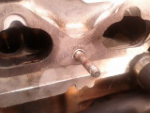

after reading a few threads, sounded like a major vacuum leak.  so I pulled the the tb and upper intake.  nothing was out of place but like an act of God, i dropped a nut into the lower intake runners so I had to fish that out.  good thing i did because guess what?  see below:
darn dowels...turns out when we swapped over the old intake to the new block, there was a set of dowels that stayed on the engine side and another set on the intake side.  so the dowels smashed against one another to create a huge vacuum leak.

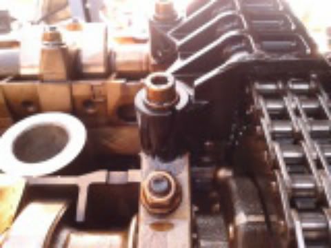

then I believe with all the bucking of the engine this happened:
can, i just unbolt the 2 bolts and replace that top rail guide?  now im worried that other plastic rails may be damaged...oh why do we love these troublesome engines!!!

« Reply #8 on: January 30, 2012, 10:13:10 AM »
The upper rail can be removed without any additional disassembly.
