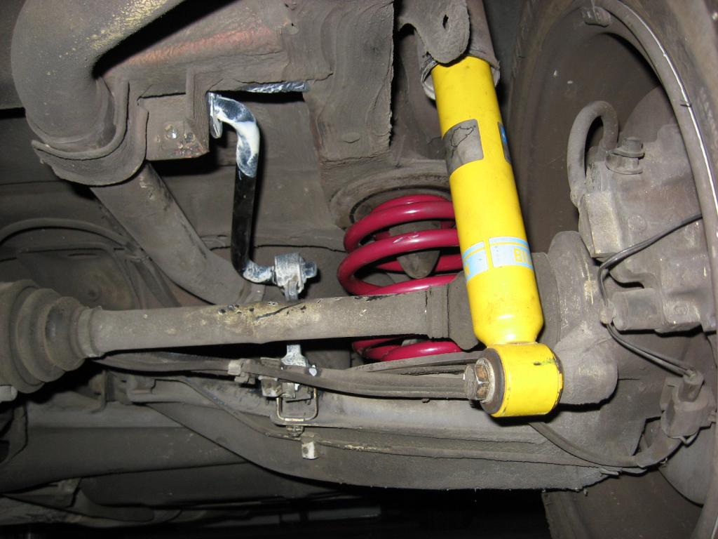

« Reply #17 on: August 16, 2008, 09:50:21 AM »
I love it when a plan comes together!
1/2 way done. Billy sports (w/heavy duty upper mounts), M3 rear bar, Vogtland springs.
I'll work on the front today.
