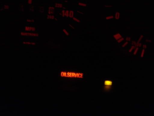

So I'm doing some "spirited" driving and...
« on: April 07, 2006, 04:10:05 AM »
after about 30 min, my oil service light goes on, in addtion to a little yellow square light. I just changed my oil/filter 2000 miles ago. How does the engine "know" when an oil change is needed? I'm guessing that the few revs to 7grand caused some sludge to loosen up and set off the light:confused: I don't mind changing my oil again, but I am just a little confused as to why it went off in 2000 miles. My oil still looks pretty clean on the dip-stick too.

This has nothing to do with your oil,
it only says oil service at specific intervals,
did you reset the light on your last oil change

As has been said above, the light is controlled by a computer, which basically "guesses" for lack of a better term, how much life is left in your oil.  If you don't reset the light when you change your oil, the computer still thinks your running the old stuff.
The yellow light just means that service is due.  It'll go out when you reset the indicator.  If you ignore it long enough, the red light will come on.  That just means that you ignored the yellow light.
BTW, next time it'll say that your car is due for inspection, as the inspection light comes on during every other oil change.

Sweet. You guys are great! It's all so clear now:rolleyes:  . I'll go ahead and do the reset procedure in abit and hopefully it goes away. Regarding the oil pressure light, only one has come on on me before. But luckily,the car just needed 2 quarts!! <---While driving my mom's car years ago--mom's and oil don't mix:p

Sweet. oil service light reset (I left the ignition on longer to reset the service light as well)! Thanks a mil.

I have heard that the lights get screwy as the SI board batteries get low. I also use a $5 continuity checker ( screwdriver with pointed end, light in the handle with an alligator clip. On my 1991 model I ground socket 7, turn the key on and in about 15 seconds the light goes out. It's in the Motor's repair manual.
