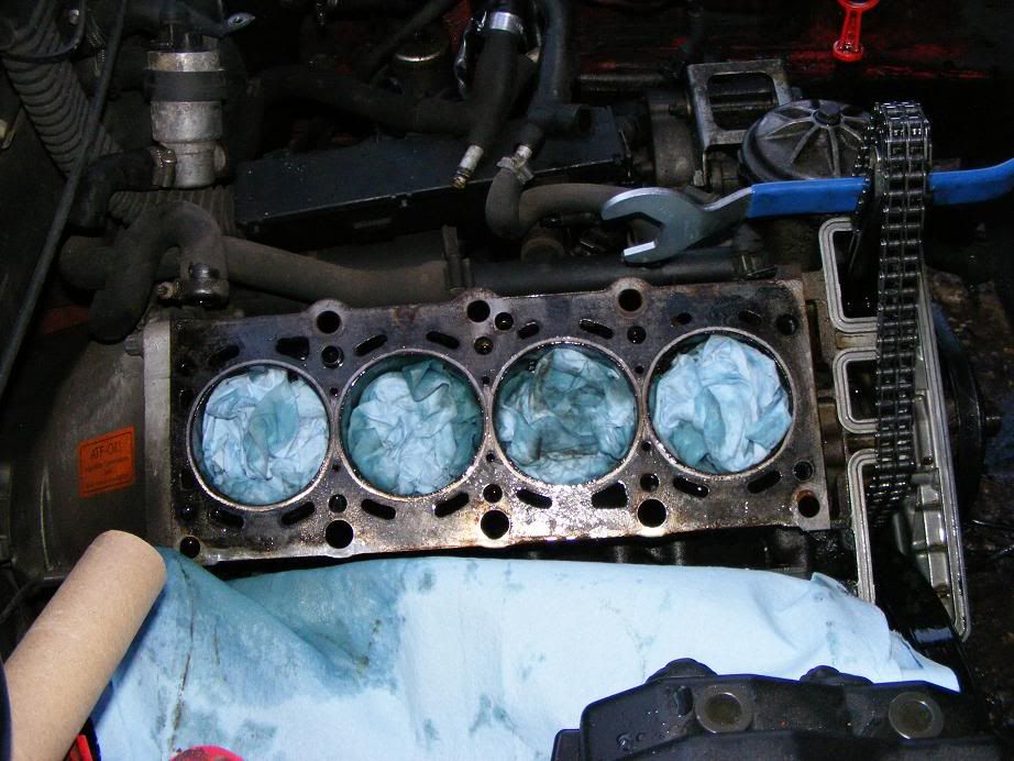

So, saturday just been and gone I drove the 50 minutes to see him (never been there before, found the house first time, given away by his E30 325i outside!) and parked up, he was getting dressed when I arrived (11am), lazy git ;)
Then we started removing everything, in the lovely -2 celsius weather we had on sat morning, with a miny fan heater between us sitting in the engine bay! It was suprisingly easy, no mis-haps, no skinned knuckles, just cold feet and hands! Marked the cams up, removed them by removing a timing chain wheel. Kept it all safe, in his garage. The head will be skimmed this week. Fortunately everything is in great conditon! Almost disappointing though, as I wanted the car faster after putting it all together ;)
So, does anyone know the head torque levels for the M42? And the torque levels for all the other bits above that too?
Is there anything to do to improve car performance while the head is off? Any porting, grinding, smoothing, etc etc to do? I'd love to do this properly and stroke it, but just don't have the money. Not even to buy some nicer cams for it!

With the rocker cover and intake removed:
M42 mit twin dells :D :
All off and 'cleaner':

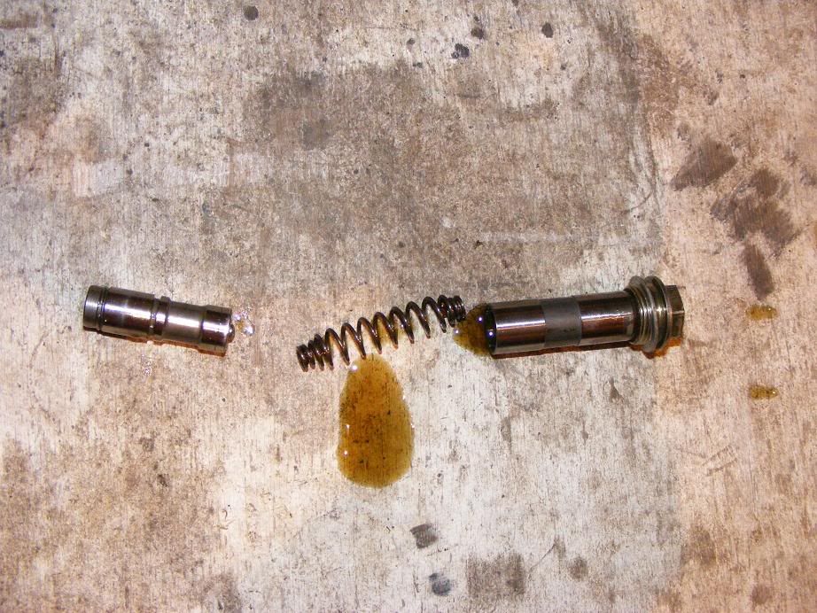

And the question; we accidently dropped the chain tensioner bolt thingy, and were wondering if this is all there is to it? Its obviously fairly important, so I'm coming to you guys, the experts and asking if I'm missing anything!
Thanks!
So: chain tensioner?

Not sure about the tensioner...  mine didn't come apart like that.   When was it last replaced?  That looks like the old style tensioner to me....
Has the timing chain been replaced?  What kind of mileage is on the motor?    I'd be looking at the timing chain, rails and sprockets before thinking about head-mods.   (or side drafts ; -)    How did those Cam sprockets look?   Have you checked the timing rails.... bent valves don't make the m42s any faster..... and neither does a cat delete for that matter.
My understanding is there aren't any easy HP mods beyond a MarkD chip.  m42's were pretty well sorted from the factory. MotorMetric has an interesting (wacky) intake manifold for the m42... but it is $$$$.
thats the old style tensioner.
its all there, but while your doing all this, i highly recomend changing the tensioner and dropping the oil pan to look for loose bolts.  its like 66$ for the lower oil pan gasket and timing chain tensioner at bavauto.com
just be careful unspringing them all the way, its a PITA to get them back together.
those are just my tips/recomendations.

I'll be changing the oil etc anyway, so dropping the sump (oil pan), and I'm ordering a replacement gasket for it anyway. NEEDING to build a guard for it, this is my 3rd sump!
Remember guys, I'm in the UK, so any US specific recommendations don't really work for me, bar getting a new chain tensioner!
UK iS's didn't have CAT's as standard, and I'm minus 1 midbox anyway, it FELT like it added a little torque if anyones interested (I had 2 midboxes, one just after the downpipe, the other just after the join. I removed the 2nd to keep backpressure).
Problem atm, is the car and engine is almost an hour away, with the head probably already at a machining shop so I can't go checking anything. The engine conversion was owned by someone who was apparently hugely anal, and I'm willing to bet the chain etc was done then, it sounds really good. Lots of people say these engines sound tappety, mines quiet and smooth typically. Oh and around 100'000 miles.
I've a cheaper headgasket kit btw, that was the price for the official german ones. The ones from GSF (german swedish french) are $100.
I'll sort a new tensioner and get everything sorted, thanks a lot guys! (and maybe find a 318iS haynes manual!)

« Reply #5 on: January 04, 2009, 05:23:34 PM »
If the head is off I would get the valves out, get them cleaned, checked and and anglecut, than regrind them into the valve seats. That should restore some of the power. Also you could drop the pan and take out the pistons. Check and clean them and get a set of new piston rings. This should also give you the opportunity to balance pistons and conrods.
