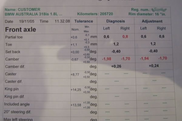

Also, the camber might be a little bit off from the last wheel alignment:

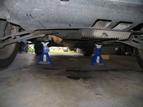

Firstly, loosen the wheel nuts with the car on the ground. 17 mm bolts here. Jack the car up and securely support it on jack stands. Everyone says it, and I will too - make sure that its secure and not going to crush you. Cars are heavy. Be smart about it. Take the front wheels off the car and place them to one side.
Get them in properly!

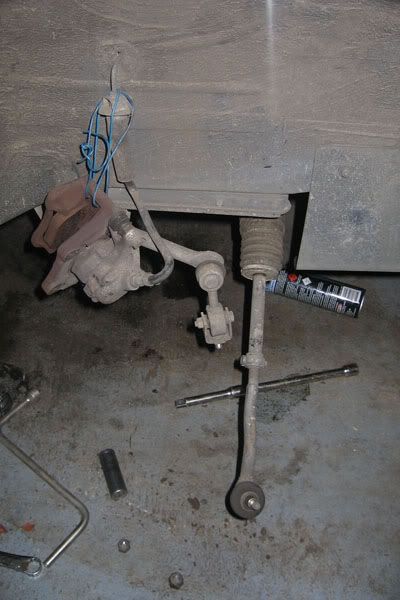

Next is the brake caliper. This is a bit of a bastard to get off, and the bolts (at least on mine) were rather tight and stiff. A bit of oil on the two 19mm bolts should help, along with turning the steering wheel which ever way to get better leverage. Once this is out, support it by any means available. Wire is one choice, milk crates are another. What ever is around really, just make sure its secure and out of the way so you don’t rip out the brake hose.

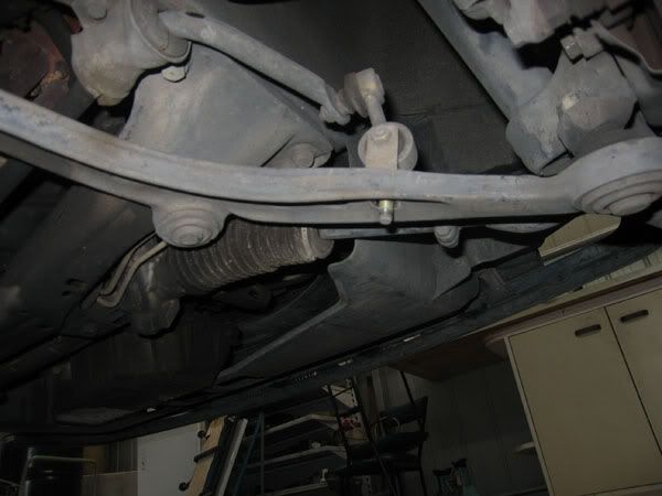

At this point it’s good to take off the bracket that connects to the sway bar. Just a 17mm nut, but I’m told that it’s rather easy to snap this bracket due to rust/old age/seized bolt/etc. Just be aware of this, but brackets aren’t that much from BMW, so it’s not the end of the world.
The sway bar bracket with nut removed
After that you need to remove the control arm bolts and the tie rod bolt. First loosen the nuts that hold the arm in, including the 22mm bolt that you need to fall into the engine bay to get to. (hint - air gun and extensions) Leave the nuts on the end of the thread for the time being though, and leave the lollypop on for the moment.
22mm bolt is circled in red. This is the drivers side, the passengers side is a little harder to reach because of all the pipes and hoses
3 ball joints, lots of fun. Again, there are many ways to do this – a ball joint tool is one option. We didn’t have any, so it was a giant crowbar and a hammer to pop it out. Doesn’t take a lot of force, just needs a couple of big wacks with a seriously big hammer and your set. Once you've gotten the tie rod and the strut one on the control arm popped out, remove the lollypop (2x 17mm bolts, don’t strip them or your shagged!) and pop off the front cross member one. Take the control arm out and set about ripping the lollypop off the end.

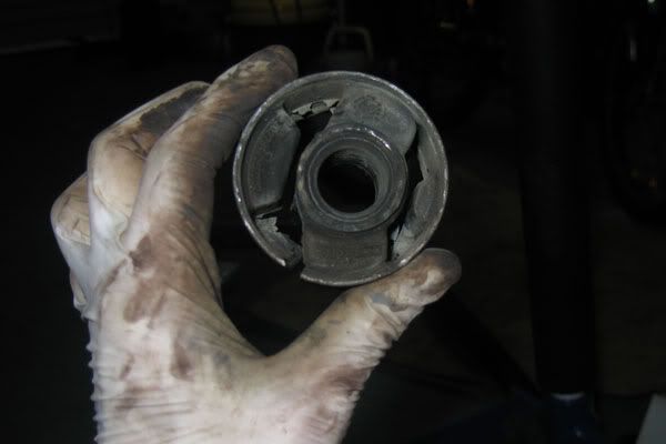

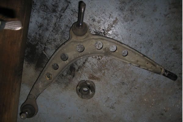

At this point I should tell you that there is no need to be delicate about getting the old parts out. They only trip they take in your car from here is to the local tip, so don’t be afraid to cut through bushings if that’s what it needs to get it out. I found the easiest way to get the old one out was to hacksaw the metal casing (be careful of the lollypop though!) and then beat the crap out of it with a combination of a hammer, chisel and socket. Eventually the bastard falls out and you can get the new one in. The better option is to take the old lollypop (bushing and all) and the new bush down to a suspension place with a hydraulic press and get them to do it.
Obvious battle (removal) damage aside, this isn’t in the best condition. The inner part has a lot of flex in it, so no wonder there was a lot of vibration at speed.
Out with the old! Of the 4 ball joints in total, one was ok. The rest had a lot of play in them.

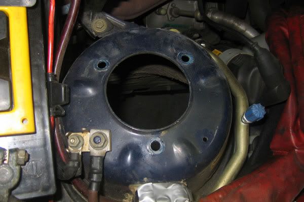

Drivers side strut top, minus strut.

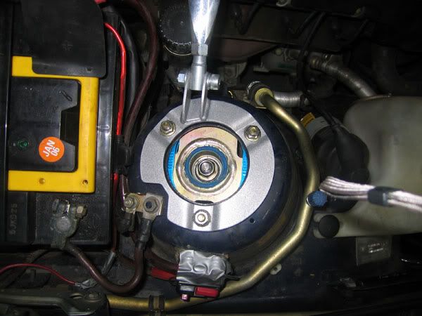

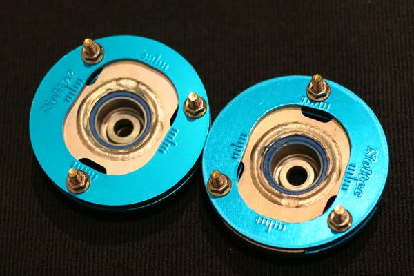

Once this is done, whack the entire strut into a spring compressor of some descript (I was lucky enough to have access to a floor standing one), compress the coil a bit to get the load off the top mount, and using an air gun, remove the top nut and mount. Put the new one on using a new locking nut. (watch the collar orientation for the noltecs)

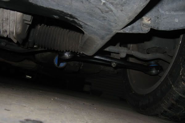

Its easiest to put the new control arm in before you put the strut back on. This is simple at this point - just put it in place and tighten the cross member 22mm nut up. Then put the strut back in (again get a mate to lift while you tighten the 3 nuts up top, its really heavy!) and put the control arm and tie rod bolts in. Tighten these up and then put the sway bar linkage back in. Almost there!
The top of the strut should look something this now. Strut brace is obviously optional.

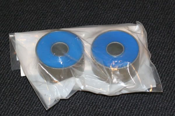

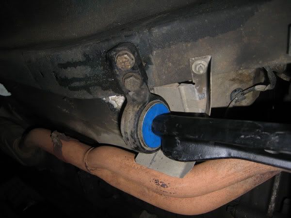

It is at this point that you want access to a press. Since this is a ghetto install, we don’t have one lying around. The next best option is a block of wood. Place the new bushing onto the empty lollypop, the wood on top of that. Then using a hammer... well you get the picture. Just make sure its on properly.
Check the torque on all the bolts now, as the next bit is time sensitive. Using some dishwashing liquid, coat the end of the control arm and the inside of the bush, then hammer the lollypop assembly onto the arm, bolt it in. Repeat for the other side and quickly get the car onto the ground. BMW recommend that you then leave the car still for 30 mins with a person in each of the front seats and the middle rear, a full tank of fuel and 20ish kilos in the boot.
Pictures of the shiny new parts!

At this point you need to go and get a wheel alignment done. When thats done i'll post up the verdict on if its been worth it or not!
