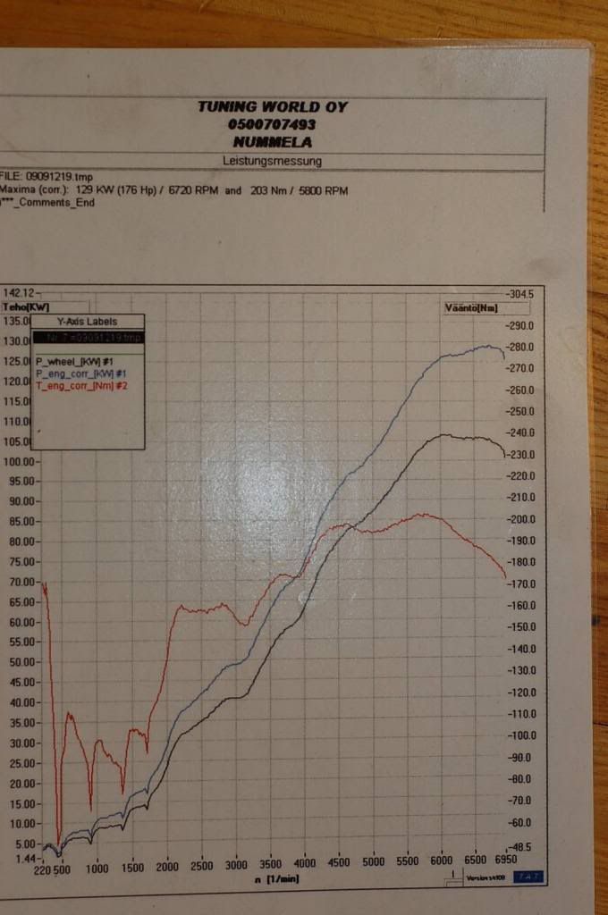

I had 176hp@6720/ 203Nm@5800 with regrind cams, slightly ported head (only intake side), 10,8cr (wiseco pistons) and ebay chip.
Ebay chip and stock injectors caused "some" pinging and corroded head. :/
In my setup stock AFM restricts badly top end power.
Now putting m40b18 rods and pistons in for a turbo :)
UUIIIIIII!!! in this case i am gonna hit the 200hp mark with my engine? :D

everything else stock? ... hmm... i have a big smile in my face right now..

« Reply #19 on: December 18, 2008, 02:26:59 PM »
Quote from: swiss318is;63129
Sorry, forgot PUG Mi16 intake valves. Those are plug n play.
Rest is stock.
Would have been few hp more by adjusting cams, but loose some from bottom end.
http://www.prospeedracing.net/
This thing has ~230hp with about same mods as mine has +stand alone & ITBs.
E30 318tic -88

hm... why do you need peugeot valves? if they are plug n play.. do they have the same diameter? doesnt make a lot of sense... and if not you need some new valveseats...bigger job on your head!
what is so special about those valves?
do you guys think i am gonna have about 200hp with my configuration?.. would be amazing.. and about the stock ecu with chip.. i can easely change to a fully programmable ecu...
in this case... it would be no problem to make a s42 replica .. ~280hp!? it seems ways too easy to me..
