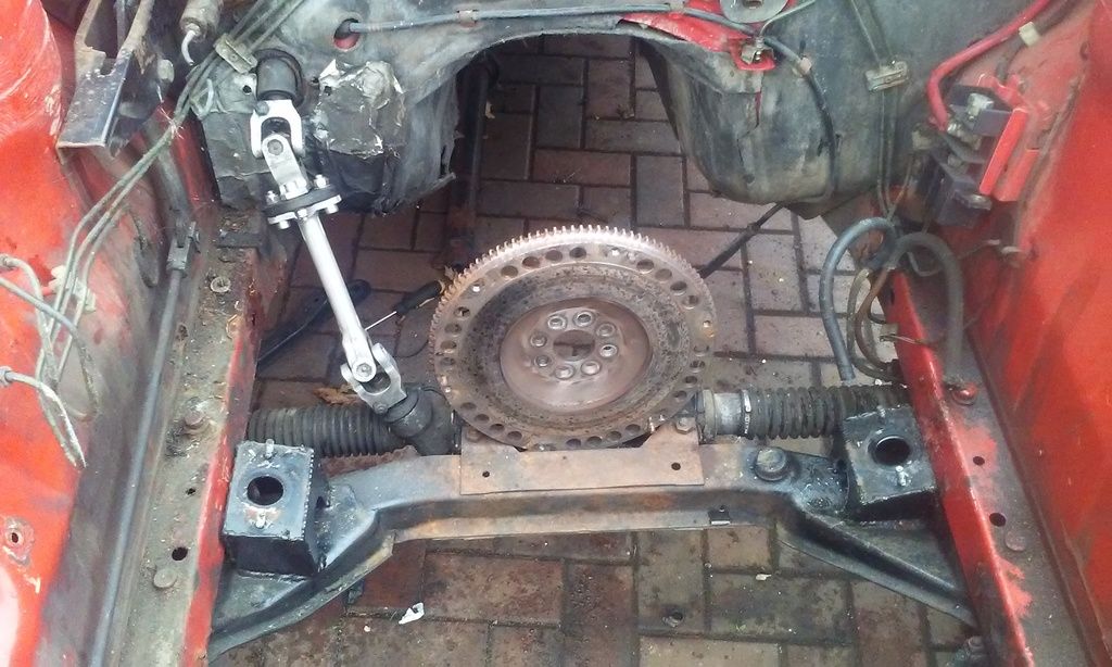

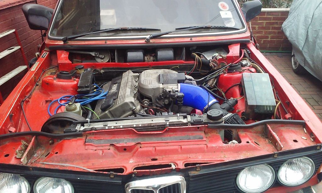

I still have the engine in the end the pistons sit about 0-5 mm below the block the engine was put together so need to strip it and deck the block
I have not touched the engine for a long time as am still building the car here is a couple of pictures with this m44 engine installed when the car is done then will put stroker in the car, still sorting rear axle.
I have had the car 8 years now 2 children later say no more
