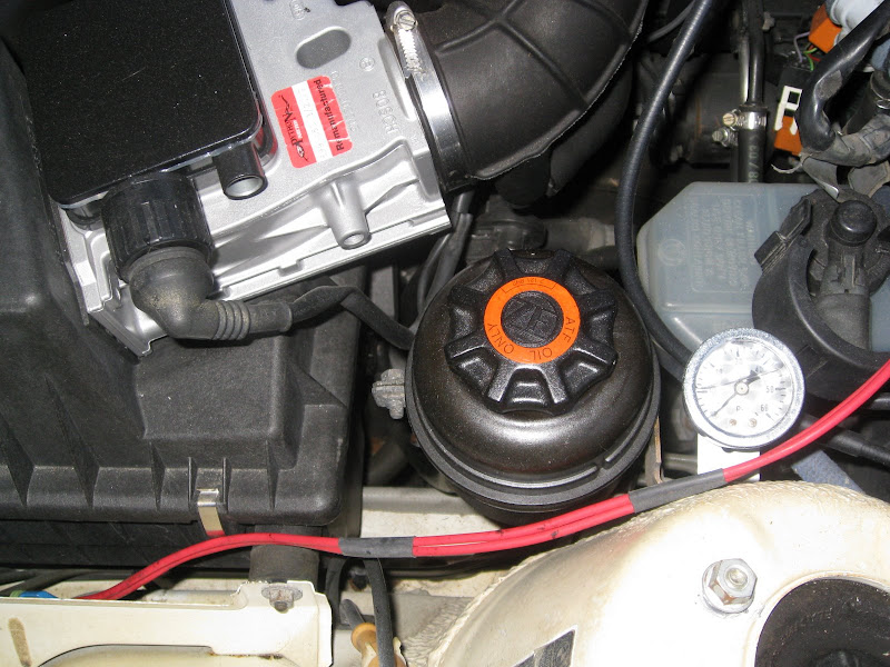

can any one show a pic of were to check the fuel pressure?? thanks

Well..... obviously you need to figure out which is the fuel line that goes into the tank and the one out of tank... easiest place to do it is when you replace the fuel filter use the fuel hose right before or after the fuel filter.

Right here:
IIRC, it is the line that goes into the black tube, but I can't recall for sure and the car is covered and outside, so it will be tomorrow at the earliest before I can confirm that...
