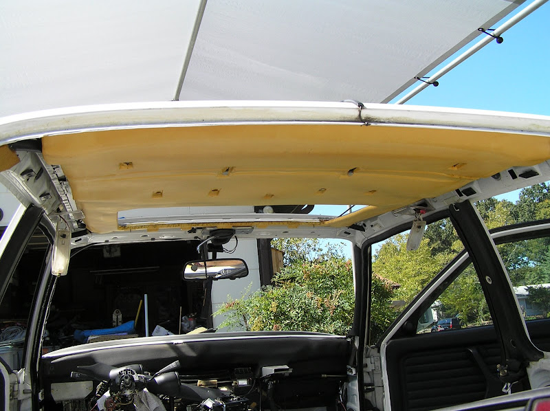

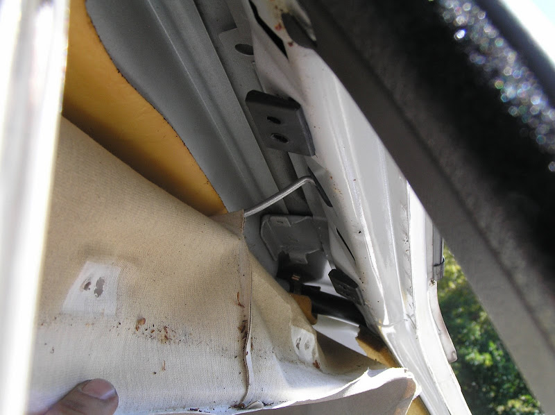

EDIT: Here's a picture of the disassembled stuff... :)
In the interests of full disclosure, I had to ask my wife to break out the sewing machine and modify the headliner as delivered - the loops/pockets that hold the rods ran the full width of the headliner on the new one, but the original has the pockets ending 4-5 inches back from the edge, to allow enough material to wrap around the C-pillar. So, the pockets had to be cut back then reinforced so they wouldn't tear through. Not a lot of work, but something to be aware of, particularly if you don't have access to a sewing machine.
In all honestly, given the amount of labor involved, unless you are absolutely committed to doing it yourself I would recommend you have a shop do the work. It wasn't technically challenging, but it was a PITA.
I used 3M Super Trim Adhesive, pn 08090, and followed the directions - 3 coats on both sides, let it sit for about 10 minutes, then stick it all together.
