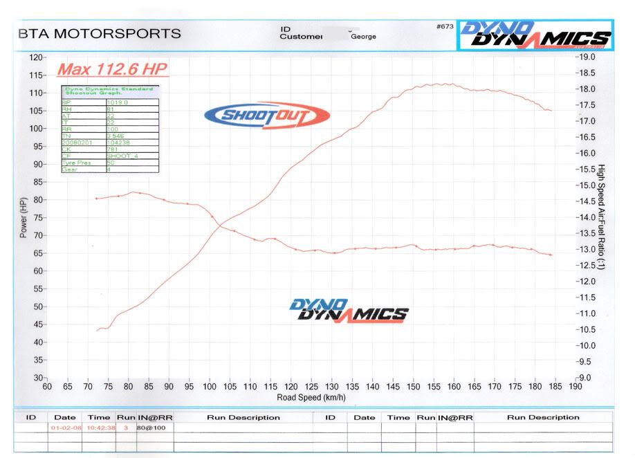

Hi folks. Any suggestions more than welcome
i put the car on the dyno today to make sure everything was ok and it spun up a dismal 112.6hp
mods are as follows:
bosch 715's 4 pintle injectors
k&n filter + added cai to stock airbox (similar to fogging).
magnaflow cat converter, stainless back box and a resonator. 2 1/4" pipework
AC Schnitzer (apparently) chip
98ron fuel (premium here is 95ron)
fan delete mod
Bosch ignition coils with msd wires
heated throttle body delete
now i recently replaced the o2 sensor which was shot but i suspect the intake pipe and vacuum mess under the manifold to be leaking? will this affect the power?
apart from that the injectors are too small and its a fair bit lean, the dyno operator/tuner said i should step up to 22lb injectors which i agreed with.
He reved it to about 7000rpm but after 6000rpm on all runs power tapers off fairly quickly
After the run i adjusted the cam timing to about 4 degrees advance on the intake cam which gave me some more 4000-5000rpm power but after 6000 it still feels like its revving for no reason.
help :(:confused::confused:

If you assume stock power than that would be a 18.4% drivetrain loss.
Given the engine is probably pretty old, it sounds about right.
How were your AFR's.

« Reply #4 on: February 01, 2008, 08:59:26 PM »
thats the graph there as you can see it is a bit too lean
ok so the dyno figures all seem to vary. Its a shame i didnt get a before run but well see how much more power we can get out of it. on this dyno with headwork and cams is it a bit optimistic to aim for 140hp?
The problem in my eyes is peak power is too early. i have another 1000rpm to play with after peak power. just have to find a way to make power up that high.
Edit: thinking about it today folks i think its fairly reasonable. I know this is an honest dyno dealing with it in the past and it seems to be an honest figure for a car that had 136hp at the fly 17 years and 257,000 km's ago :) I was expecting a little more reading the grassroots article where they made a supposed 130ish rwhp with similar mods. Driving it today as well it doesnt feel all that much slower than a friends e36 328i vert

Mine did about 125hp stock.  I have no power steering or a/c robbing power either.  115 or so would seem about right if those are still on the engine.  I got about 130 with a Mark D chip.  Seems like that is a fairly good tune for a stock engine, it made more power and torque pretty much everywhere.  I haven't had a chance to go back and play with the cams yet.  Mine simply wouldn't make power beyond 6500 rpm with stock timing.
If you want more top end you'll need to retard the intake cam.  Advance will give you more low end but the power will taper off more quickly.
