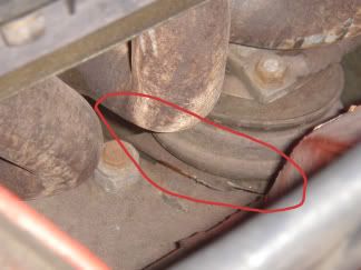

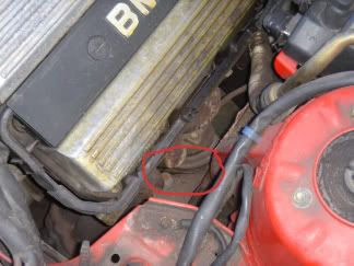

To add to my great week, I noticed that I would get a clicking noise when breaking hard. Pop the hood and look what I find:
Can someone break it to me how bad this is?

That doesn't look good. Were the mounts on your to-do list by any chance?
yes they were

Take it to a shop and have them remove the motor bushing on that side, support the engine while they remove it, then reweld that piece back to the subframe, it should be stronger then new when done

Thanks gunni, I think I am gonna try that. I think its the engine carrier so Im going to see if one is available and which option is cheaper, welding or replacing.
