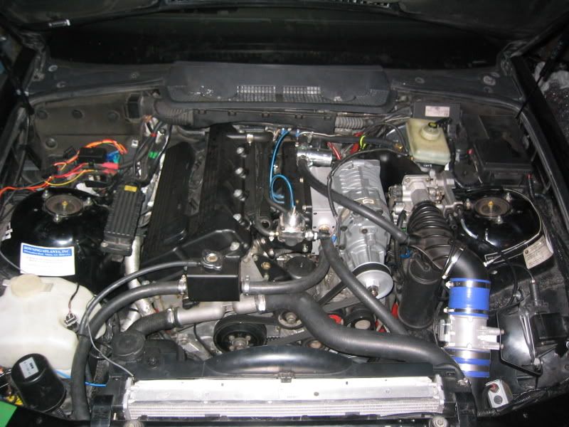

supercharged? pics pls!

« Reply #6 on: May 30, 2007, 12:44:29 AM »
Quote from: Febi Guibo;26736
As requested, here are some pics:
