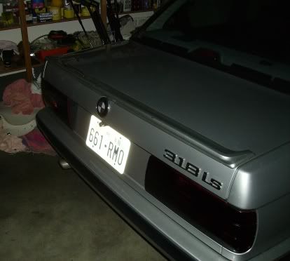

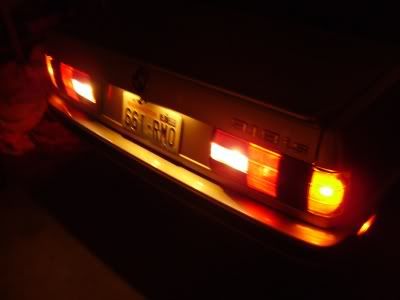

Anyone smoke the tailights DIY?
« Reply #39 on: March 13, 2007, 09:39:56 PM »
Here's a teaser. They wont be this dark in the daytime outside of my garage. I'll take some more tomorrow to show what they'll actually look like.
They still light up nicely atleast.
