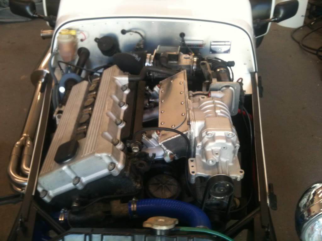

« Reply #22 on: April 27, 2013, 09:15:04 AM »
Early version of the plenum has now gone and has a tidier looking one in now, excuse the battery charger in the picture as car had not been started for several very cold months it needed a bit of help !
Rolling road is booked for a couple of weeks time, will video and post results.
The supercharger is from the mini cooper S.
Note: rocker cover colour change is due to having to swap engine after a rather painful oil pump failure not caught in time.
« Last Edit: April 27, 2013, 09:17:44 AM by riche »
