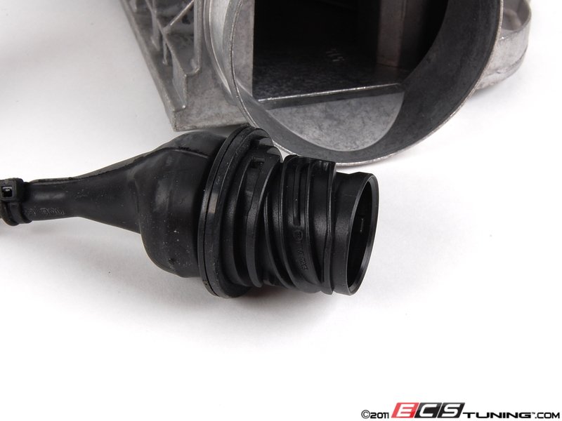

Basically, when i was doing a whole lot of cleaning and tidying up under the hood (mess under the intake, etc), i noticed there was an extension cable on the connector to the airbox.  I took it off (it was like 8 inches) and i found that it still reached and connected.  I just thought, "well that's redundant" and got rid of it and tossed it in my trunk.
For the next week, i kept having the same issue where it wouldn't start or it'd start and die then after a few minutes it'd start up fine, only to die again a half hour later.   A 4 hour drive to pittsburgh took me 7 or 8 hours from all the dying and whatnot.  I could figure out what was going on and my friend thought my car was a death trap and she was afraid to go back in.  While there, i started poking around to see what could be the issue.  Frustrated, i just plugged it in as a hail mary and just to stop it from moving around in my trunk and everything went back to normal.  I guess it's resistored or something?  because at the end of my poking and prodding, the only change i made was putting it back in.  it never came back again
long story short, do you have the extension plug that goes to the MAF, because i think you should, unless it was coincidence.
That is a resistor pack from BMW - one end of the cable has a little inline plastic housing under the rubber boot. It was a BMW service campaign to improve idle quality, believe it or not. I had the same item in my car, thought the same redundant thought, and pulled it out. Glad I did - the end that connected to the AFM connector was filled with water, causing a no-start. The car has run well ever since!

Are you saying that when you took it off it made things better?  why would it make mine worse?
