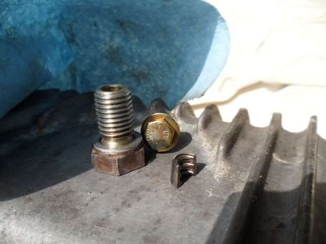

Well...here's one of my first surprises. Took out the lower oil pan and found 2 objects:
1) Upper oil pan internal bolt - no big deal not too worried
2) Valve stem collet!?!? - WTF
I've found out PO had someone do similar job to what I'm doing now. Gasket's I've been removing seem relatively fresh still, which is good.
However, just wanted opinions about #2, valve collet. I've removed camshafts and confirmed all collets are there and installed just fine.
Do you think someone just accidentally dropped it through an oil gallery while doing some valve work previously? Any concerns I should have?

This motor is very vocal when pistons & valves make contact, so unless it sounds like a diesel engine when it runs, you are most likely fine. If you were able to visually confirm that all of the collet halves were present & accounted for in the head, then you can probably chock this up to a careless mechanic.
My advice is to pick up one of these:
http://www.turnermotorsport.com/p-1798-magnetic-oil-drain-plug-for-most-bmws.aspx
When my timing chain deflector sprocket blew out, this sucker neatly collected up all of the loose ball bearings. It also helps to pull all of the ferrous filing waste out of the oil during normal operation, which can help lengthen bearing life.
Anyway, glad you caught this stuff. The collet could have ended up in the oil pump (the screen on the pickup is virtually worthless). That upper pan bolt can now go back in, with some thread locker (I'd apply some to its neighbors too), and you should be good to go!

Yeah I ran 20k on it before doing all this work so I had doubts it'd actually be missing. Just wanted to confirm though for some better sleep at night! haha
Upper oil pan is all out so definitely some threadlocker going on those when I put it back in.
