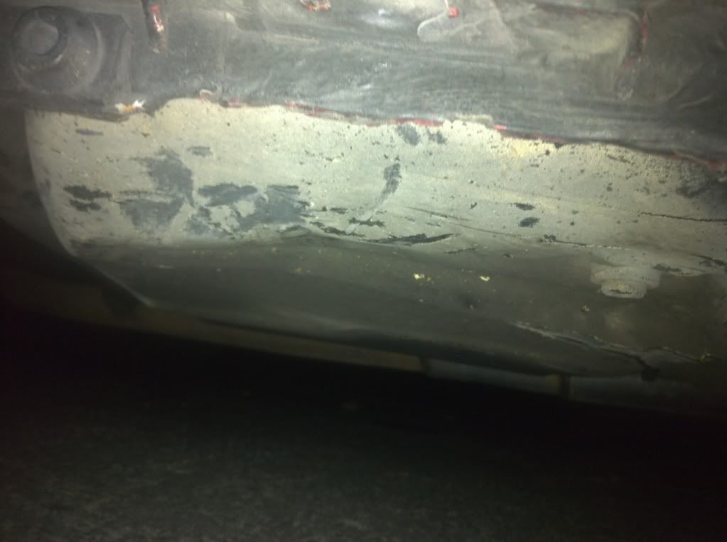

thanks for the insight. though I haven't gotten to that yet, I may have found my missing gallons. I went under the car just now an I realized that my fuel tank, on the passenger side, was pretty banged up.
responding from my phone so I apologize for the huge photos
shot from the side
shot from the rear towards the wheel

maybe you smacked the tenk so hard it crushed a rubber vent hose.  I guess a dent could account for some volume loss but not half of it,  I wouldnt think
