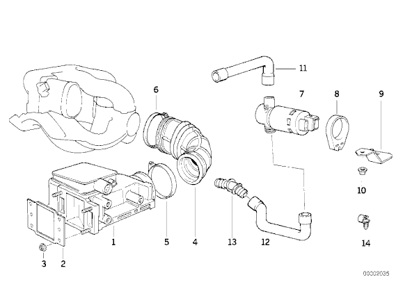

Doesn't the ICV go from pre-throttle body Via intake Boot to the icv and from the icv to the intake manifold Post throttle, body?
I was wondering how i should set mine up if i must keep it.  My setup will be, pretty much like you said
Air filter  >  AFM  >  intake boot  >  throttle body  >  Supercharger  >  Airbox/internal cooler  > Intake manifold  > engine
So the stock setup goes from pre-throttle body, and bypasses the throttle body correct?  so if i did that, it would end up on the boost side, because anything after my throttle body will be boost, since the throttle body is pretty much right on the supercharger.   Any thoughts?  Is it OK to run the ICV on the boost side with sufficient clamping.  Curious to know if it will leak internally in the Valve itself, if exposed to a boost condition.
Would it be best for me to make a bung for the icv on my small pipe that connects the throttle plate to the supercharger? Would that be a correct way to do this?
Stock setup

So i was really Bored and thought you guys could use a good laugh at my MS Paint skills :D
so this picture describes my question.
option 1 grabs fresh filtered and metered air through the ICV and routes it to the non pressurized intake flange pre supercharger.
option 2 grabs fresh filtered and metered air through the ICV and routes it to the pressurized intake box, post supercharger
Which one would work best for me ?

imo option 1 is better since it doesn't interfere with the blower.
(as far as I understand your paint skills)
with option 2 there is a chance of blowing air back into the intake boot... if boost is high enough...thus anything more then ambient air pressure!

Yeah i am not sure if the valve can handle boost or not.....i'm wondering if it will idle rough giving it the icv air before the blower.

option one is the way to go. It wont see boost there and it will control idle fine.

Thanks guys,. I will go with option 1
