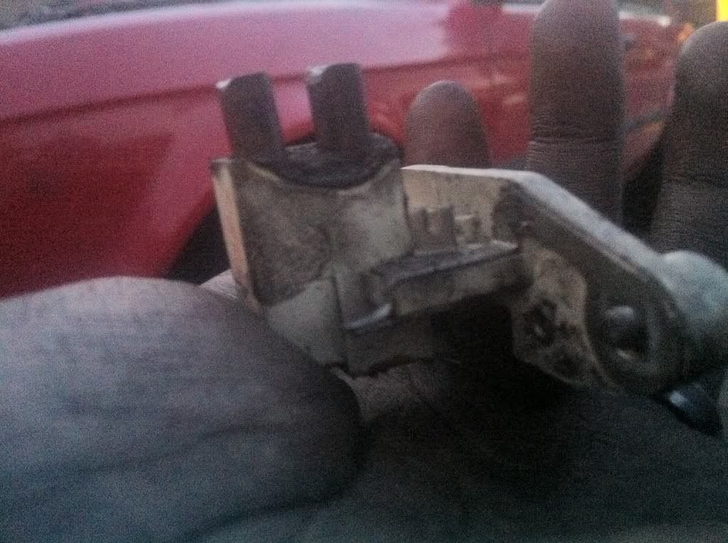

my power steering recently blew up, fluid everywhere, idk why. don't really care about it since i plan on taking it out. but i think fluid got into the alternator or it could've been coolant spill.. so i took out the alternator, inspected the brushes and from what i've been reading, voltage regulator. at first i just noticed that one of the brushes were pressed in, and there were a bunch of fillings, then i flipped it over and from the looks of it, mine is completely toast. i still brought it over to autozone though. i was pretty sure it was going to fail, i was just wondering if the test was going to say which parts failed, aside from the visually obvious candidate. but i guess not. the car starts when you jump it, but will eventually stall and shut down. evident with the radio first, then the with the tach. then the car dies. is there way to check the rest of the alternator..? open it up and look at it? or is there a way of testing resistance and stuff like that..? this is my first time dealing with electrical stuff.

That looks bad, but they're really overbuilt...might still be OK  There are a few tests that I do on my bikes.  A PM alternator is somewhat different, but I'll see what I can find for you.  They sit in an oil bath on most bikes, so I wouldn't worry too much about oil on the coils.
Basically you have to test the individual circuits in the field coils and on the armature for breaks or high resistance.  The diodes in the rectifier/regulator circuit are more likely failure points, but that's easily replaceable.

I read the other post...that regulator update might be a little less than you need.  Looks like the brushes definitely shorted out with all that arcing damage.  I'd definitely inspect the rotor contacts for damage at the very least...or get a spare used alt just for peace of mind.

thanks for the schooling DesktopDave. that really enlightened me. i was able to source an alternator from a 08/1990 325i  from the yard that looked new! at first i popped the voltage regulator and the brushes were untouched. peeked the rotor and it looks new as well.. yanked it out. put the regulator back in.. dropped by several autozones to have it checked and it passed. all of them noted that it sounded a bit noisy though.. i just got back from my quest and will press onto the disassembly. :D
