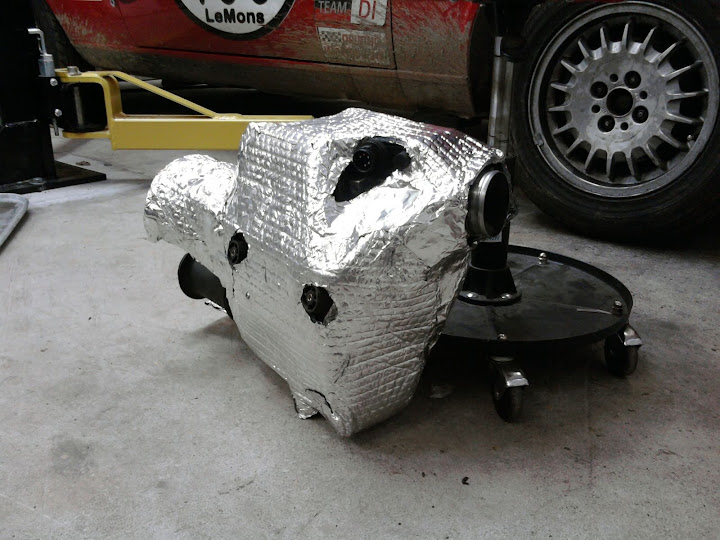

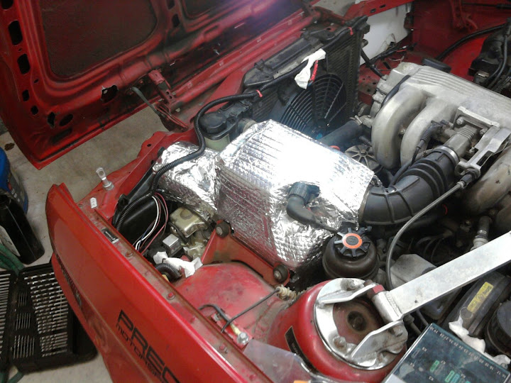

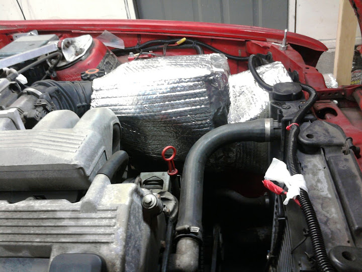

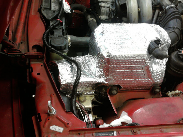

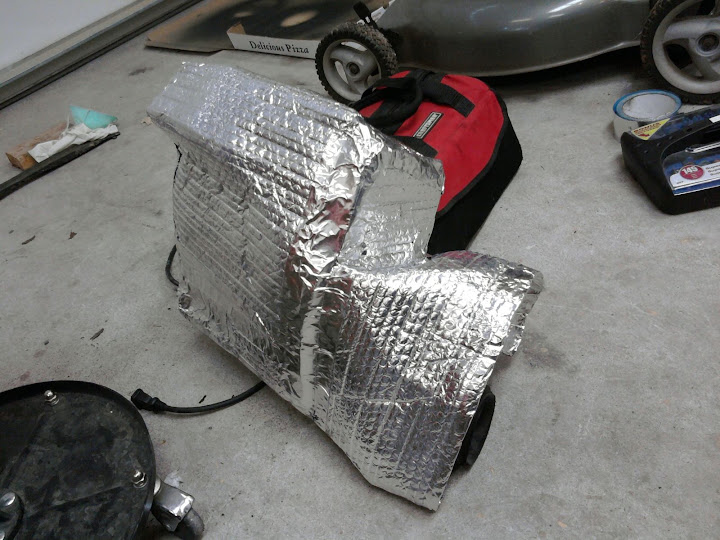

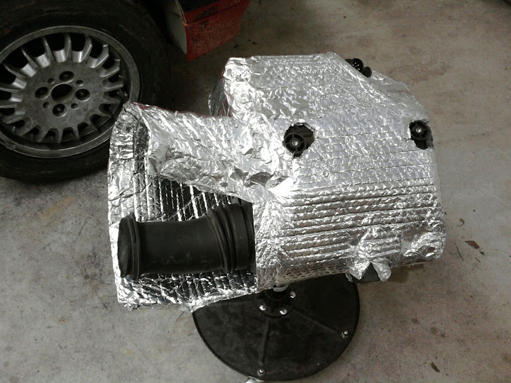

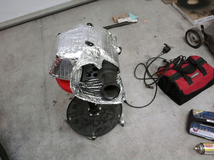

In my
quest to find a little more HP

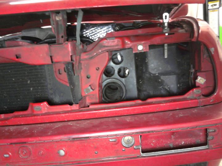

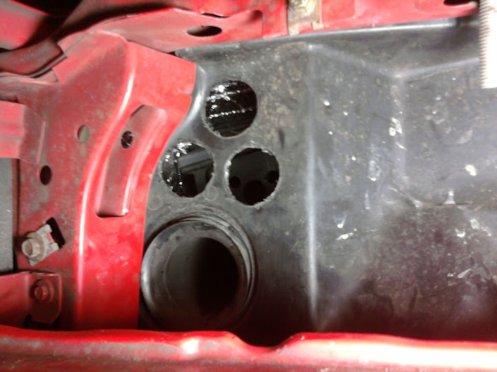

on the cheap I insulated my stock fogged airbox from the engine heat and made it so that fogged openings on the air box only get cold air. I added openings in the front plastic sheild to allow cold air in to the fogged holes. I also added several more openings to the air box since it was now only getting cold air.
Parts needed:
1 roll 16" Reflectix ($15 Home Depot)
1 roll Aluminum Foil Duct Tape ($5)
I basically removed and wrapped the stock airbox in the Reflectix usinig the aluminum duct tape to secure it. Then added an extra peice of reflectix in the engine side for more insulation. And finally added another peice to the front of the box to cover the hole in the front so it could only get cold air from the headlight area. I added aluminum tape to the front edges of the flap that extends to the headlight opening so that it could be easily bent and hold its position.
More pics here:
http://picasaweb.google.com/ScottBarton76/BMWE30ColdAirBox#
-Scott
