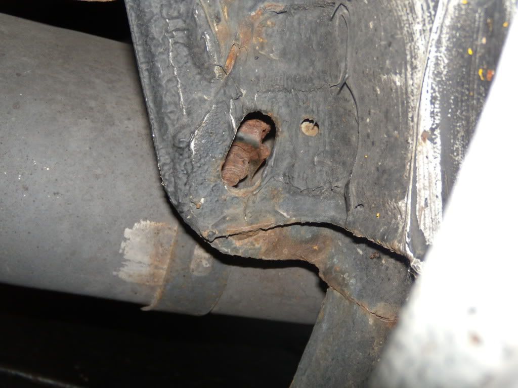

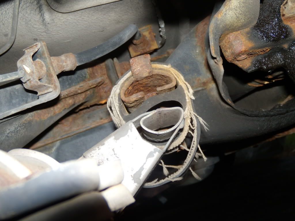

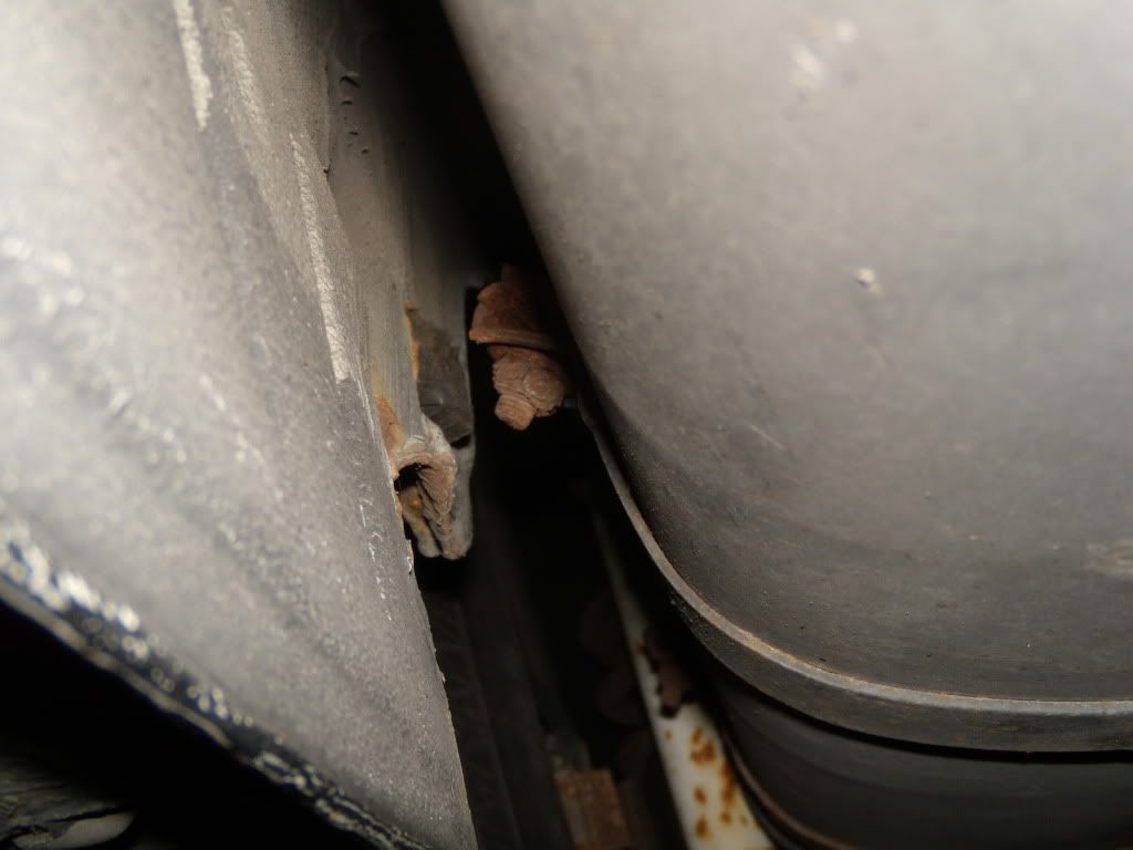

« Reply #6 on: November 23, 2010, 07:07:07 PM »
Sorry for the delay.  Couldn't make it home for the weekend.
Pics of the contacting area:
The hose was a temporary diagnostic solution
Muffler hanger connection:
Next hanger down the line (kinda worn):
Missing exhaust bracket here:
And a video of what's happening (couldn't drive to show the noise when driving cuz it's off the road atm)
« Last Edit: November 23, 2010, 07:09:12 PM by e30Andym42 »
"Objects in mirror are slow"
Transmission Exhaust Bracket
« Reply #7 on: November 23, 2010, 07:19:18 PM »
Yeah, I'll bet you could bend that a little to get it right.  The muffler straps can be tweaked, especially at the top where they attached to their rubber doughnuts.  The rear subframe hangar (with the shot rubber doughnut) is bolted on and can be adjusted...it slides up & down to give a bit more flexibility.

« Reply #9 on: November 24, 2010, 04:43:58 PM »
I'm not seeing any adjustability.  The hangers appear to be welded in place, and then they attach to the doughnuts, and the bracket.  Hard to see without dropping the exhaust...Or maybe I'm blind.
I did notice that the rubber doughnut in the second last picture is not actually doing any supporting.  Maybe if I replace that, and go to the dealer for help with the tranny hanger, and get that, then that may solve my problem..

« Reply #10 on: November 24, 2010, 06:41:18 PM »
They're not adjustable in the conventional sense.  I just bend or tweak them a bit to fit the purpose with some large channel lock pliers or a vice.  A judicious bit of bending here & there will make them perform as designed.
In your case, I'll bet that defunct subframe hangar is twisting the system out a bit, letting it rub the body.

« Reply #11 on: November 25, 2010, 10:51:18 AM »
Duh... Okay, I'll attack the bracket with some vicegrips when it's not raining.  That should solve it.  Thanks a lot!
