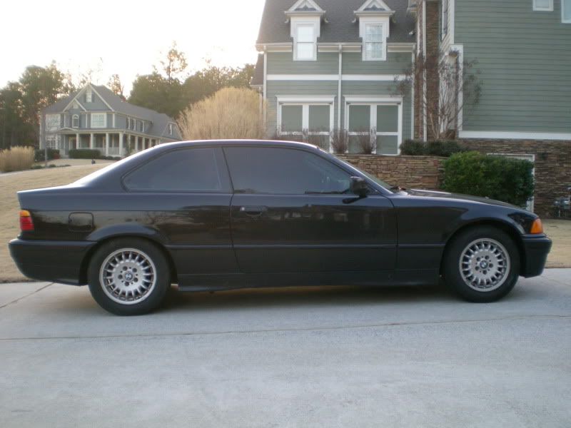

here is a picture of her

PS:  I think you need lowered Eibach springs or something you wont regret it.

azrates, I have a Bilstein H&R suspension on the car now, It lowered the car a good bit, the car is my DD and I drive in Atlanta, I would be worried about going too much lower
