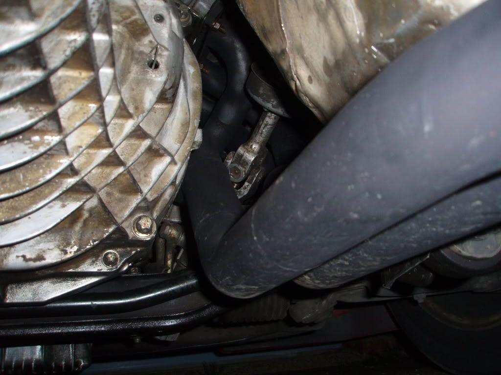

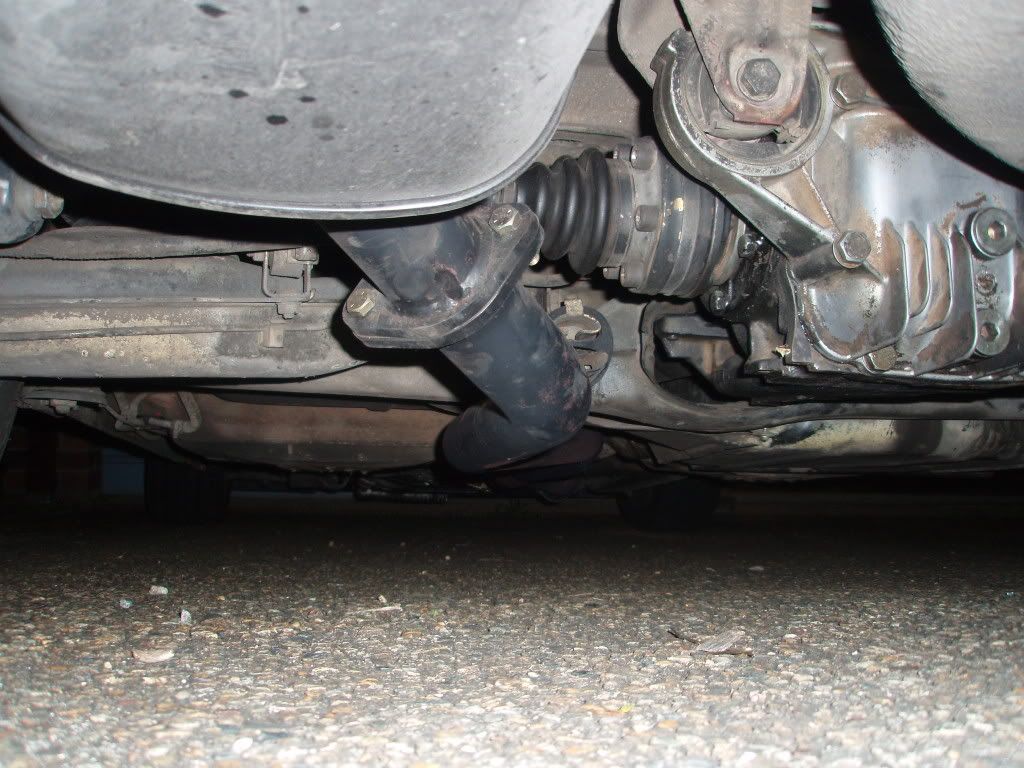

Hi all
so i got a new exhaust a few weeks ago and thought i should do a writeup on it. its fully custom made mandrel bent stainless steal. i got a custom made 4-2-1 manifold, the rest of the system is 2 1/4 inch with a small hotdog cat and hurricane muffler. i havent had the car dynoed or anything but you can feel the power difference up on the rev rang. it was done by brian at exhaust innovations in brisbane.
hear are some pics and a video, btw sorry for a crap photos

« Reply #5 on: August 07, 2010, 04:11:15 AM »
Great looking piece, but your diff mount seems to need a bit of replacement...

« Reply #7 on: August 15, 2010, 01:36:03 AM »
wow!!! you went around the outside of the steering coupling to solve the RHD clearance problem...this is what my friend did for us...
http://www.bmwclubmalaysia.com/forums/showthread.php?t=34143

« Reply #8 on: August 21, 2010, 09:05:38 PM »
Quote from: xsjado;95510
there is a thread here as well...
http://www.m42club.com/forums/showthread.php?t=9299

« Reply #12 on: August 24, 2010, 09:22:09 AM »
Quote from: M42_Jester;95211
wat was the total cost for this? and is it compatible with an E36 318iS??
The steering coupling on the E36 would be at a different position compared to the E30. Actually more space, relatively and would not need to go around the steering coupling...
