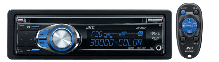

I'm installing a new head unit into my E30 and while I've been able to figure out what all the wires are for, I am concerned that the 12V+ wires seem a bit small.  Are they adequate for an average aftermarket radio head unit?  The unit I will be using is this one here...
Also, how highly recommended is it to run new speaker wires?  I'd rather not if its not totally necessary.  The front speakers are still stock while the rears have been replaced with something better.  I hope to be replacing the fronts soon after this HU install.
Also, I picked that unit because... A. it was cheap and B. it can change to a nice orange backlight to match everything and C. It has a good Aux in.

I had to tap another 12v wire.  Some of the Japanese units use far too much power on the memory wire (yellow, IIRC).  The switched power was adequate.
I was looking around in there for a hot 12v+ source...pulled 12v+ off red wire in the hazard light switch harness.  It's always powered and I'm guessing it's 12 gauge.  I've tested it with my Blaupunkt cranked & the lights blinking, no problems at all.

That was my suspicion.  Thanks for the tip on the 12V+ wire.  It seemed like the 12V+ wire on the new head harness was a lot thicker gauge than the wire I was supposed to connect it to :)  I'll try the hazard light wire as you suggested.  And I agree with you, I'll probably never use the CD player itself, all I want is the AUX in for an MP3 player.  Now a head unit with direct SD card and usb drive access would be pretty nice....
The guy at the store kept trying to point me towards "nicer" more fully featured units, but I kept talking about the way it looked and how it had to match the interior of the car.  He thought I was crazy.  This unit seemed to have a minimum of chrome and the infinitely changeable backlight color feature looks like it'll match perfect.  I thought maybe making a custom sized roundel sticker to put on the volume knob for an added touch.
